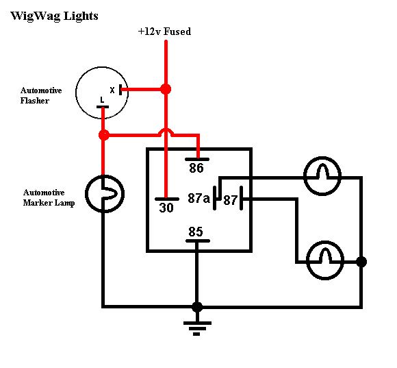

dk2400
hotwaterwizard
Silver - Posts: 1,350
Joined: December 11, 2003
Posted: December 19, 2006 at 8:46 AM / IP Logged
Explain better.
I think you want to hook some Indicator lights up so you can see when  the Wigwag circuit is on???
indicators to relay -- posted image.
John DeRosa (Hotwaterwizard)
Stockton California
When in doubt, try it out !

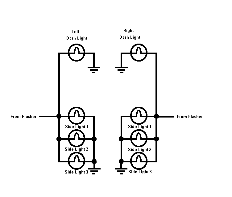

shaun leong
Joined: November 30, 2006
Location: Philippines
Posted: December 20, 2006 at 7:51 PM / IP Logged
Hi
No im running three 21w lights each side of the car two 3w lights on the dash board. Totaling 174w. Do i need to run them into a relay if so how do i do this.
thanks Shaun
dk2400
hotwaterwizard
Posted: December 20, 2006 at 9:30 PM / IP Logged

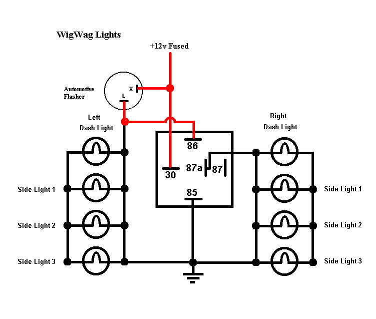

hotwaterwizard
Posted: December 20, 2006 at 9:51 PM / IP Logged
If the lights already work and Wig-wag, just hook the wires in parallel with the existing lights on each side and to the dash lights .
