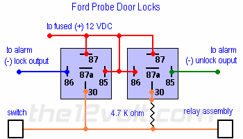

thanx for the reply. i read it but it still doesnt explain to me how i would wire a grand am that only has a single lock/unlock wire. how do i get the doors to unlock when i press the unlock button on the remote and so on. i see people talking about resistors and diodes and the door lock diagrams are confusing to someone who has never installed an alarm/remote start before.thanx
Mike M2
Platinum - Posts: 2,652
Joined: June 29, 2005
Posted: December 17, 2006 at 9:30 AM / IP Logged
 I can't find a diagram on the Grand Am, but it wires like the Ford Probe with two differences. First, instead of 87 going to 12volts they will go to ground. Second, the 4.7k resistor needs to be 1500ohm. Everything else stays the same, no diodes are needed.
