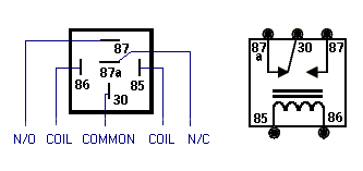

It looks like you can use a standard Relay until you find your timer.
Intercooler Sprayer Wiring -- posted image.

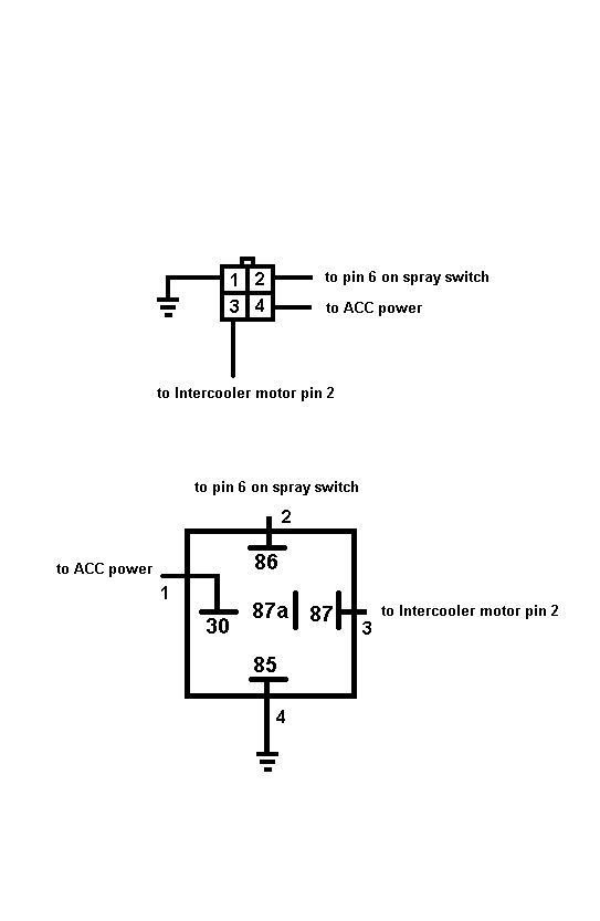

I should fix my original pics, and add another that shows the back of the switch:
My Scematic #1
My Scematic #2
Switch Pin Out

anyway, I forgot to ask how I can determine what pins do what on the switch?
I KNOW that pin 2 and 4 are correct, but there are many other opinions on what the others do.

Posted: December 19, 2006 at 10:29 PM / IP Logged
Pin 85 is a ground not a hot. It will not work with hot on both sides of the coil of the relay.

Are you sure you got it?

latest version:
