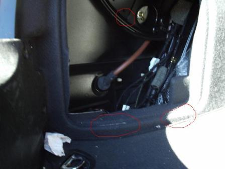

Well my box is done but im having a bit of a hard time figuring out how to mount it any idea's?

There is no space under to box to mount a bolt and i only have about 1/2" lip on the fender well.

weld a tab in? i'm sure its not outside body metal in that place...

I think what im going to do is f/g tabs on the bottom of the box to fit in the slots (2-red cirles at bottom of screen) Then the red circle on the top has holes already so im going to run a threaded rod threw the box with metal and rubber washers.
