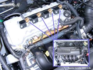

I'm installing a Bulldog 200 remote start system. I can get the engine to turn over, but not long enough to start. I need to hook up the wire that runs to the tach. I know where to find the harness, but I'm not sure of which wire. (The instructions say the black wire in the #5 pin) I'm looking for the #5 pin. If anyone has a picture, or can give exact info on which one it is, I would be most greatful.

you can catch black inside........but heres another way. go to a fuel injector.......each injector will have four wires, 3 of the colors will be the same on all four injectors, use the one color that is different.

man....i was trying to upload a pic for you, but i cant figure out how to do it...................

finding tach wire for 06 Corolla -- posted image.alright, heres the pic

MIkvot, those are the coils, not injectors. The coil closest to the oil cap, use the white wire...
