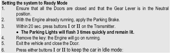

also did u put in ready mode.
90 Ford Probe GT Clutch Type? -- posted image.
