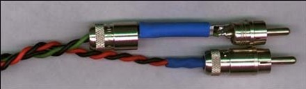

I agree that an aftermarket LOC, especially one touted as "high quality", is better to use than the amp's built-in high level converter.  But with either one, do this:  twist the input wires that you attached to the OEM speaker wires.  The twist is + wire and - wire around each other, about 1 to 1 1/2 twists per inch.  This should effectively eliminate induced noise into this vulnerable length of signal input wiring.
noise using loc on kicker zx700.5 -- posted image.
An example of how the wires should twist.  Never mind the RCA plugs.
