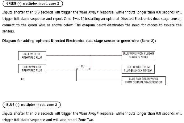

jason quarters wrote:
there is a loop at one end and the other end has a blue wire that goes to the blue/white wire to turn off shock sensor when in remote start. thanks but i do have a idea!
In an odd way Jason is right that if we shunt a data line to ground no data can get thru (as JWorm rolls his eyes viper 791 in rsx - Page 2 -- posted image.  ). Here's the logic: smash your car and no one will steal it - effective but unecessary. viper 791 in rsx - Page 2 -- posted image.  A short circuit will always have a negative effect on signals.
It's the wrong way to get things done! (JWorm smiles viper 791 in rsx - Page 2 -- posted image.)
We created a short circuit just the same and it's uncalled for as was mentioned earlier.
The shock is bypassed at remote start as it is programmed this way in the EEPROM.
Here's how it's supposed to be done ! :
