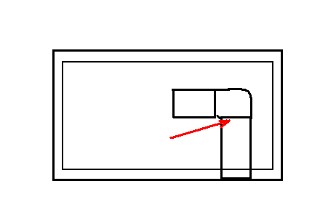

cliff design cd120c - Page 2 -- posted image.
The higher tuning freq at 45 Hz (8" port length) will cause more rattling than the lower 35 Hz (full 15.4"length) tuning.  But the lower tuning will make all your music sound better.
