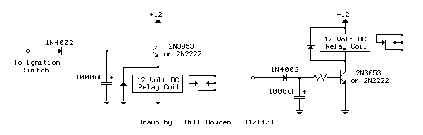

I have a relay on my electric fuel pump that also turns on another relay for my Ignition box. The power to the coil on the first relay is from the ignition switch but runs through an oil pressure switch. If oil pressure should drop below 7 psi, I think, it will drop my fuel pump relay which in turn will drop the ignition. What I'd like to do is have a 3-5 second delay in the fuel pump relay.
Does anyone know if I can get a time delay relay for automotive use, 12V?      Or can someone suggest a way to incorporate a resistor and capacitor that would delay the drop of the relay 3-5 seconds.
Thanks
hotwaterwizard
Silver - Posts: 1,350
Joined: December 11, 2003
Posted: February 19, 2007 at 9:28 PM / IP Logged
need to time delay a relay -- posted image.

Thanks John, I'll give it a try. How durable would you think that circuit be? This wiring is under the rear of the bed on my hot rod S10 ext. cab V8.
hotwaterwizard
Posted: February 19, 2007 at 9:48 PM / IP Logged
Put it in a Plastic Key box if you like.

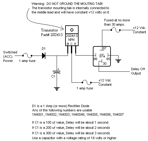

Here is another circuit.

Would it matter if the wire coming off "E" terminal of the transistor is about 10' long? Acc power comes from the fuse block, I could implement that circuit under the dash if the long run would not matter??
Thanks.
In the second example, the resistor, which is not specified, is what controls the length of the time delay?? How about the first example, what controls the delay time, only the size of the cap?

hotwaterwizard
Posted: February 19, 2007 at 10:06 PM / IP Logged
Wouldn't matter.
