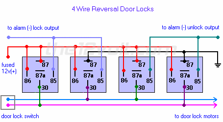

You could try something like this-
bmw power folding mirror? -- posted image.
4 wire reversing relay configuration
Is the power to those wires controlled by a momentary switch that you manually control or there some logic in the mirrors that stop the motors at the limit stops?
If you use the setup shown in the diagram you have to make sure it can never get both "lock" and "unlock" signals active simultaneously- normally with a mechanical switch it wouldn't be a problem, but it may be better to modify it so it's protected against that.
I'd suggest making a modification to the circuit as follows:
-Reverse the terminal connections on relays 1 and 3, swapping 30 and 87.
-Break the connection shown for terminal 86 on relays 2 and 4, disconnecting them from the fused 12V.
-Connect 87A of relay 1 to 86 of relay 4.
-Connect 87A of relay 3 to 86 of relay 2.
That should keep the relays from shorting 12V to ground if both the lock and unlock inputs inadvertently get activated at the same time.

Thanks for the help the door only gets the power for unlock or lock never both. I wanted to use the power sent to the door lock to operate the power side of the mirrors so when you lock the car the mirrors go up and when unlocked the mirrors go down. can't I use the power sent to operate the lock to send to the relays. Also the when you lock the door or unlock the door it sends the signal for a little over a second the cuts off so it wouldn't burn out the mirror motor.If you can draw out some kind of diagram it would really hope and please remember I really don't know to much about wiring.
