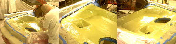

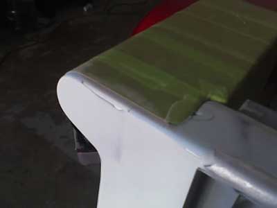

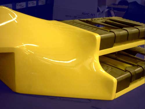

Mix good quality body filler like “Evercoat Rage Extreme” with polyester resin to thin it down.
Carefully mix in cream hardener (50:1) so that you don’t introduce a lot of air bubbles.
Paint the mixture on to your rough project with a 2” disposable brush
Sand down to desired shape with 80 grit on a 3” DA

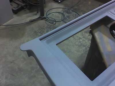

Spray on guide coat
Sand flat surfaces level with 36 and then 80 grit with a long block. Sand radiuses with a soft block
Spray on high build primer
Paint

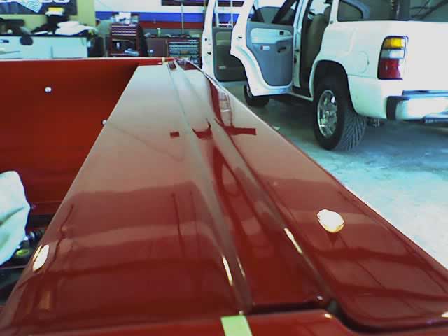

I use this trick on every fiberglass project and save dozens of hours of sanding and refilling every time. It works on curved and vertical surfaces as well as flat surfaces. It makes creating perfectly flat and level surfaces a snap!
Think about it if mixing some body filler, applying it waiting for it to cure and then sanding it down only takes you 30 minutes every time you encounter an imperfection or an air bubble, how many half hours do you have to waste in a day?
Sorry about the crappy pics. I took them with my phone.

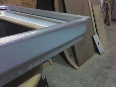

I have been using this method for many years now and I have tried every mix that you can think of. What I have come up with is that using just cream hardener gives you the best sanding window(15-20 min of sand time). Basically just put in the same amount of hardener as you would if it was just straight body filler.
Remember this is a multi step tip!
1. The mix
2. Using the paint brush instead of a bondo card
3. Sanding after the filler setsup but before it fully cures
4. Using guide coat (check out your local paint shop and ask how to properly use this stuff)
5. Quickly level your project with heavy grit sand paper (get rid of the waves)
6. Let a high build primer take care of the scratches left buy the sand paper.

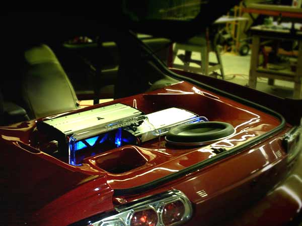

fiberglass trick of the year -- posted image.
This amp rack took me les than an hour too go from fleece to paint. Also don’t forget to reinforce with real glass (I have a trick for that to!). If you do not, the sun will cause your project to crack in a dozen places after a couple of weeks, making you look real bad!

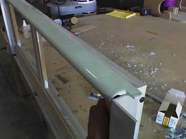

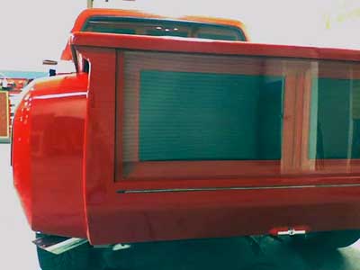

And don’t make the mistake that Scott and I made here. mix mo more than 1 sq. ft. at one time or it will harden completely before you can do your magic. This project took me a full day and a half of extra sanding do to this mistake.

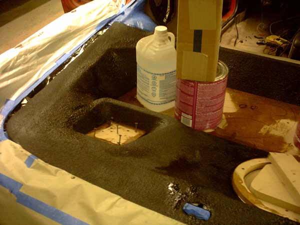

What’s important to realize is that after you form your project with fleece, and you have this really good look going on, it’s ok to lay down some chop fiber glass, resin and then a layer of Marglass (short hair fiberglass reinforced body filler).
You don’t have to worry about your project being perfectly smooth. The resin/body filler mix will take care of that.
I have seen countless installers mess up a good project at this point.
The installer will knock his knuckles against the hardened fleece and say “that’s pretty darn strong” and then skip the glass entirely. Or only glass from the back side.
What happens when the fleece and body filler expands in the heat of the sun and the glass reinforced layer beneath dose not? It CRACKS!
It is critical to reinforce both sides of fleece with glass!
Resin soaked fleece is extremely unstable. It will shrink 7-9% initially in the first week and continue to expand and contract in the heat and the cold forever. Anyone who might not believe me on this should go to a resin producers web site and check out the technical specifications of polyester resin.
Keep on mind when reinforcing that the glass is the strong part. Glass its self will not expand or contract.
On the Back side of my projects I will often pour a mix of Kitty Hair (long stranded fiberglass reinforced body filler) and resin. It takes 2 minuets to mix, 1 minuet to pour, and 10 minuets to harden. This is the fast way. It works just fine in most cases. The trick is to become familiar with just how much your mixtures and layers will shrink and how stable they will be from that point on.
