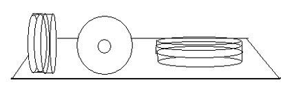

I recommend that you use some type of a board for stability.  And solder.  I would arrange the crossover components in a way that fits the space I have to put them in, drill holes through the mounting board and zip tie the components securely into position.  Then, use small lengths of primary 16 ga. wire to connect components, using solder for the connections.
If you have two coils in a crossover network, arrange them so that they are at 90 degrees.  The mounting board will stabilize their positions in regard to each other's.
Here is a depiction of 3 coils, each 90 degrees from the other two:
x over? -- posted image.
18 or 20 ga. air coils will be superior to what you would get in most commercial component crossovers.
