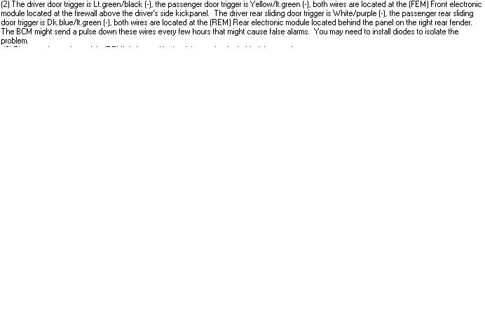

03 ford windstar door trigger proble - Last Post -- posted image.

This may help ya...   get a relay 86 to +12v on dome light wire, 85 to (-) side dome wire, 87 to ground, 87a through a 500 ohm resistor to 12v, 30 to (-) door pin input wire.    Aparently these things fall asleep and then the dome light wires will switch polarity..
