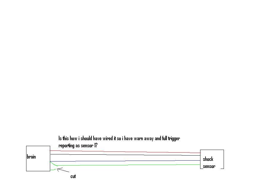

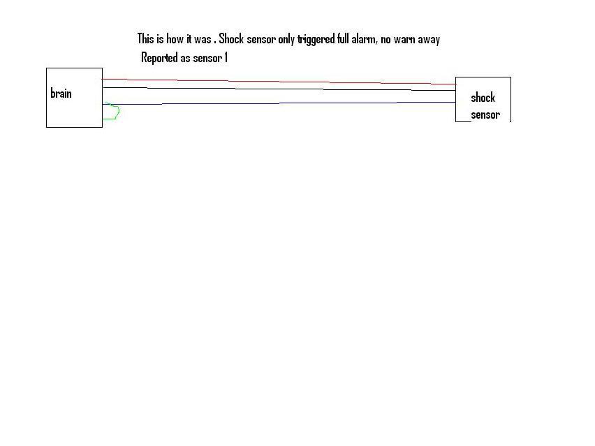

I have a viper 5900 sst.  My shcok sensor would only do full triggers and no warn aways so i wired it a little differently. Now I only have warn aways and no full trigger. I drew a diagram of what i did. Could somebody please help me out with what i did wrong here? I want the shock sensor to do warn aways for light hits and full trigger for hard hits. It is a dualstage shock sensor.
Colors mean:
Red- positive
Black - ground
Green-warn away
Blue - full trigger

I got this situation figured out. It is working how i have it wired right now. I think it wasn't working b/c i had already triggered the NPC system so it wouldn't go into full trigger.

The green loop side of the wire harness should be plugged into the shock sensor. The other green wire that goes to nothing is for adding additional sensors.
