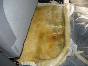

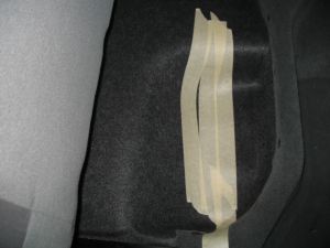

I have started this box for my 2006 dodge ram. So far I have made the the bottom shell and did a second layer of glass. I plan on doing one more layer in sub area even though it is pretty stiff already. After that I plan on placing it back in the truck and tracing my cut out line on it and figuring the placement of my sub ring and amp rack which will go on the right (its pretty obvious where it will go). I am building this mostly because there are no boxed to fit my boston 10" g5 sub for this truck in this particular location, and of course because it will look badass. I am really planning as I go here and will update as I go.

first fiberglass project. -- posted image.

Nice work so far, just make sure that when you set your sub ring into the enclosure that you account for the cone excursion and that it is set lower than the sides of the subwoofer ( have it recessed ) and this will ensure that the sub cone will not hit the bottom of the seat.

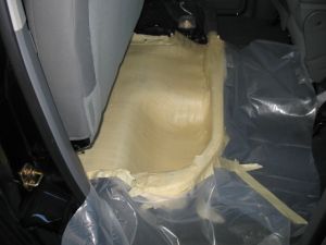

Went a bit farther tonight, not sure how this is going to go. If things dont look right soon I am going to cut the amp out of the equation completely and just put it back under the seat. I left my staple gun at work so I will get to that either tomorrow or thursday.
You can see that the 1/4" ply is not cut to the shape of the front of the fiberglass, I am either going to just fg that area and sand it out and bondo it or will recut the bottom piece. I left my jigsaw at work as well so I didnt have the means to cut it properly and while I am sure I will regret it later I will likely just put in the extra work.
[IMG]https://i45.photobucket.com/albums/f78/Speakle/Zoeandmaddy003.jpg[/IMG]
I finally got the fleece set and resined (is that a word?). I am thinking I probably will have to tweek the amp area, make it square instead of leaving that curved area in the front. I am not sure yet, I will se how it looks after I get the fleece cut out and the amp temporarily set.
