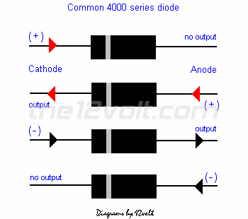

I need to use my GWR(-) to trigger several things in an '03 Maxima --
1) Bypasskit immobilizer bypass
2) Antigrind relay
How do I diode isolate it?  Thanks

2003 maxima, ultrastart 1270tl -- posted image.You want to be able to "put thru" ground, and NOT have any voltage "feed back."
Install your diodes on SEPERATE wires for each to be triggered with the cathod towards the device to be triggered.

KarTuneMan wrote:
...Install your diodes on SEPERATE wires for each to be triggered with the cathod towards the device to be triggered.
You want the ANODE side of each diode toward the device you want to receive ground from your ground while running wire. The cathode side (side with stripe) of each diode should be connected to the ground while running wire.
2003 maxima, ultrastart 1270tl -- posted image. the12volt • Support the12volt.com

It appears Im dyslexic....and wetahded.....looking right at the 3rd diagram....2003 maxima, ultrastart 1270tl -- posted image.
