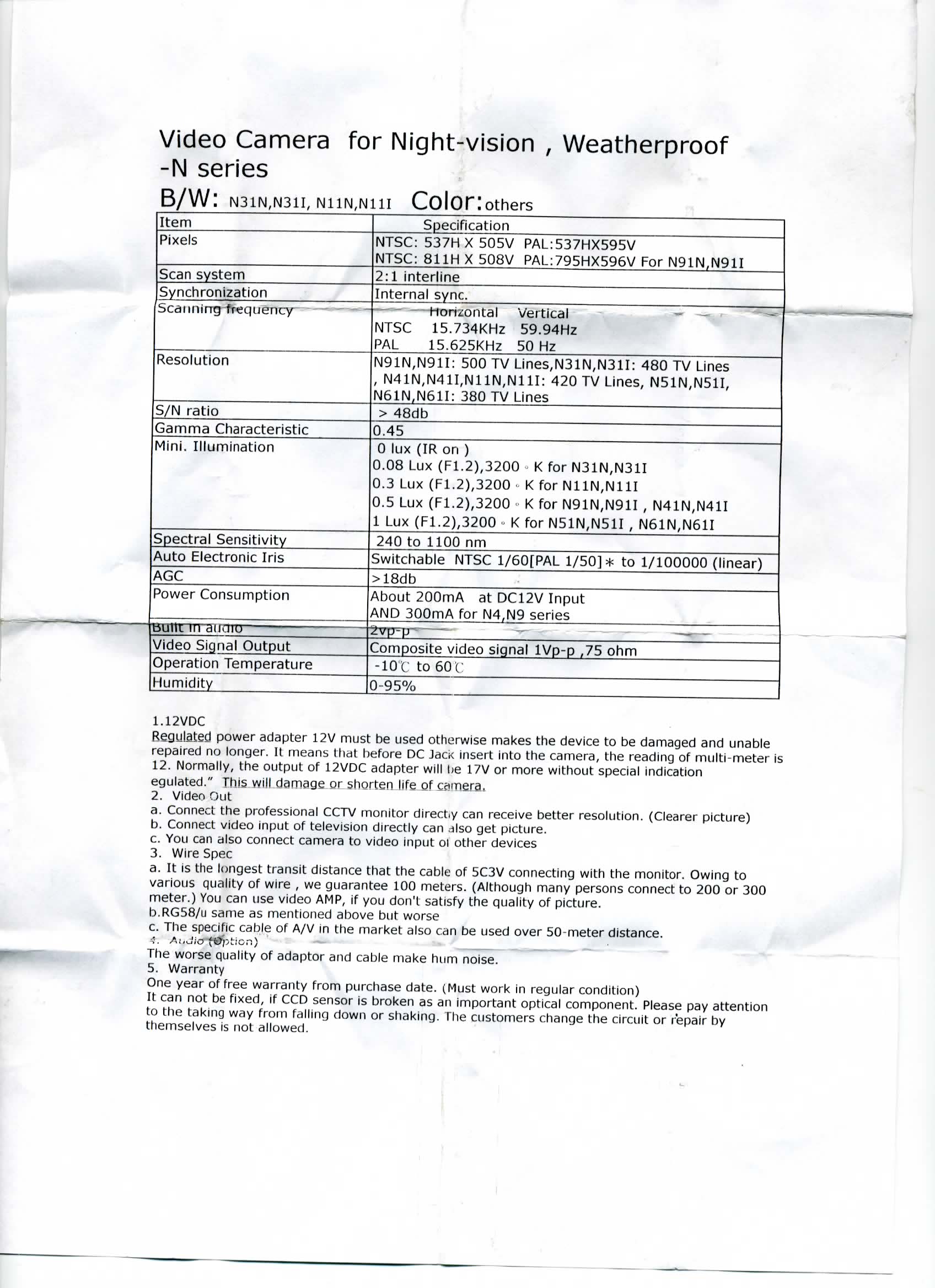

thats what i thopught then i found the installation instructions and this is what it said
problem w/back up camera -- posted image.
