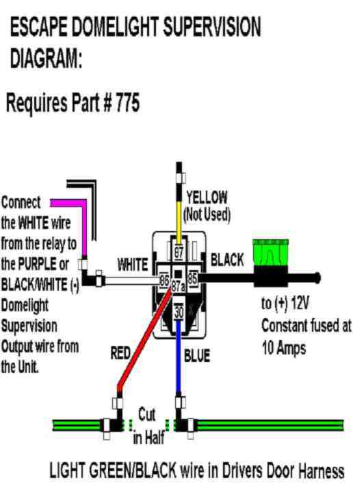

Hey can someone help me where and what is the wire that plug 86 goes to i can not find it in any of the wiring diagrams posted. Here is the picture i am looking at please tell me if i am looking at the right thing. Thanks for any help

That diagram is correct for your 02 Escape. Pin 86 is the negative dome supervision output from your aftermarket system. DEI lists this info for wire color and location:
Dome Supervision      lt GREEN/ black              drivers door harness

Yes i found the GREEN/ black wire but where is the wire that the white wire on the relay goes to.

Well, since you did not post the make and model of your alarm/starter I have no idea. Which is why I posted "Pin 86 is the negative dome supervision output from your aftermarket system".

Ok i understand now thanks a bunch for your help
