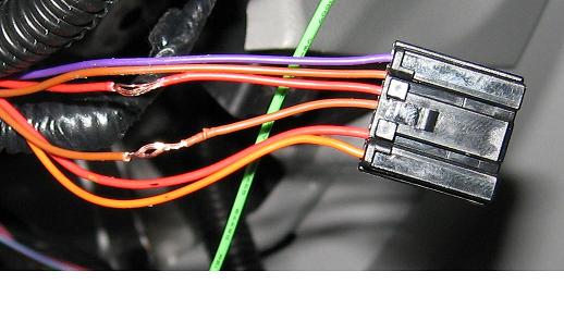

If it's anything like my 07 camry I'm working on, the color won't help. Basically if you look at the key cylinder, it should have like a clear plastic around it. (it' lights up the key hole or something) anyways follow it and it should attached to a black connector, where you can unhook it from the immobilizer. The reason why the color won't work is because some wires are the same color. Best bet is to look at the connector and see if any wires are missing... i.e. for my car it was
1 Orange
2 Red
3 No Wire
4 Brown
5 Red
6 Brown
7 Purple
Because #3 had no wire and the instruction said 5 & 4 that would be the correct number as oppose to the other way around.
oh, don't forget these things are 1 time program so don't mess up. :-)sienna fortin bypass module tx rx wire -- posted image.

dnt408, kewl deal on the pix! sienna fortin bypass module tx rx wire -- posted image.
I will definitely double check now since Toyota should use the same parts anyway...
By the way, is yours a type G connector as indicated by Fortin manual?
