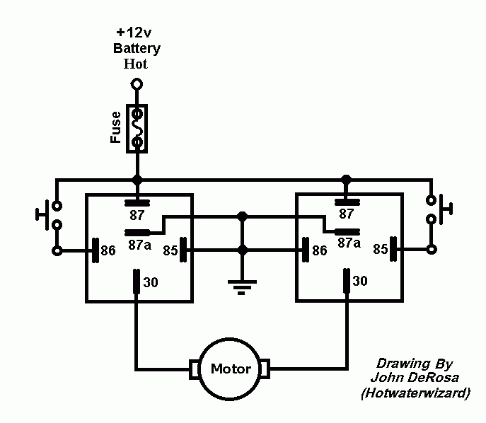

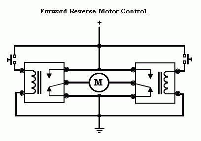

is there a way to rewire the windows to bypass the factory door module  but use the original window switch? i picked up this car at the local auction and only the drivers door window and door lock works
hotwaterwizard
Silver - Posts: 1,350
Joined: December 11, 2003
Posted: April 17, 2007 at 7:46 AM / IP Logged
You could treat it just like an actuator.
First find out the wiring of the switch with a meter and then you can substitute it for both of the push switches in the diagram.
2001 pontiac bonneville window wiring -- posted image.

Posted: April 17, 2007 at 7:48 AM / IP Logged
here is another view of the same circuit.
