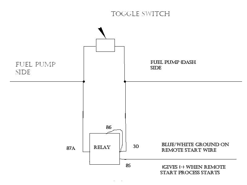

legend1011
Member - Posts: 25
Joined: September 11, 2005
Posted: May 12, 2007 at 12:40 PM / IP Logged
starter/fuel/igntion kill w/ remote start -- posted image.
Would this work?
I think it would be great because I can still turn the physical switch off breaking the circuit, but If I remote Start it will bypass this switch. I'm guessing I still will have to flip the switch before I turn off the remote start feature with my key to start driving. I think it would work great! What do you guys think?
pitoaudiovisual
Copper - Posts: 388
Joined: April 25, 2005
Posted: May 12, 2007 at 1:52 PM / IP Logged
once you get in the car you still have to physically turn the switch off its just to bypass it when the switch is on..

legend1011
Member - Posts: 25
Posted: May 12, 2007 at 9:07 PM / IP Logged
Just to let everybody know I tested the design above I made and it works. If you remote start the relay is the fuel pump switch (turning the fuel pump on). If you put your key in and press the brake to deactivate Remote Start then it will turn off the relay killing the fuel. You have to be sure to flip the physical kill switch prior to deactivating the remote start when you are in the car. Pretty cool and safe plan to follow. Actually it's better cause you have two fuel kill switches.
