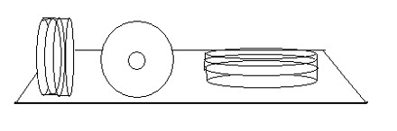

Quite honestly, that's a magnet on the butt end of that woofer.  I install coils as far from magnets as possible.  This pic shows 3 coils each at 90 degrees from the other two:
inductor -- posted image.
Your pic is correct, but a bit too close for comfort.

Okay, so i'll keep it as far away as possible,which is only about 6" away. I'll keep it about 90* from the voice coils position.

Jantzen coils are top notch.  They will be true to specs, don't worry about it.  I don't sand the ends of the coil wires to solder, I just solder them as they are.  They solder fine with anything from 30 watt pencil to 100 watt Weller, from my experience.
The big benefit of ordering custom parts is that the parts are ready to assemble without measuring them and making changes.  You are not winding your own coil here.
6" is a good distance.
