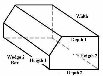

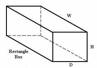

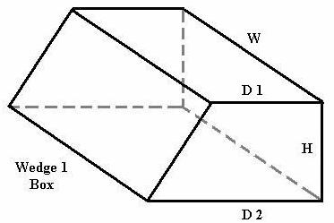

Well you definitely have enough air space in the vehicle, but now there are the aesthetic and architectual questions that we need if you would like a design from us:
1) What style of box are you looking for? Wedge, Wedge II, Square, Cylinder, Rectangle? Is it wood or fiberglass?
ported enclosure design -- posted image.
2) What is the maximum size we can design for you? In other words, how tall is the inside of the trunk? How wide is it? How far apart are the trunk lid hinges (if they go down while the trunk is closed as in most cars)
