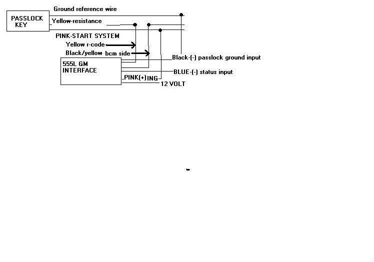

djmonchi
Member - Posts: 7
Joined: July 27, 2007
Posted: July 30, 2007 at 1:08 PM / IP Logged
I installed the passlock interface, but nothing happen, this is the diagram, do you know the color of the sensor oil cable?
 2000 chevy s-10 alarm wiring trouble -- posted image.
Mr.Perez
xtremej
Gold - Posts: 1,440
Joined: February 24, 2006
Posted: July 30, 2007 at 1:39 PM / IP Logged
sensor oil cable? huh!
swerks
Copper - Posts: 224
Joined: January 12, 2003
Posted: July 30, 2007 at 4:18 PM / IP Logged
wats a sensor oil cable?
