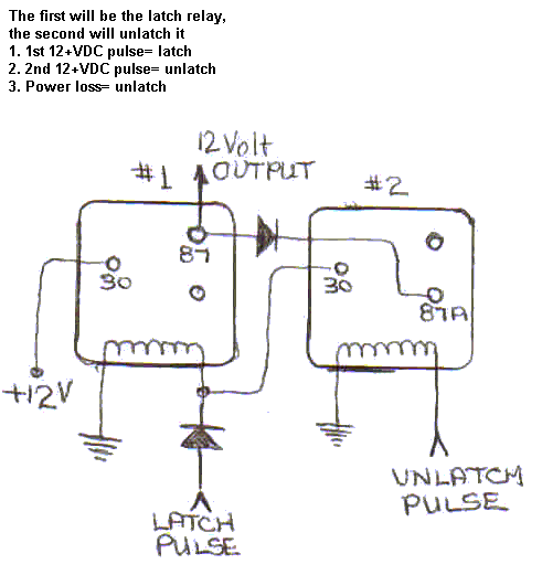

This is the picture of the switch provided by your link. It is wrong .
push button switch to latching -- posted image.
Here is the correct Diagram
As for the relays here is how it is done.
John DeRosa (Hotwaterwizard)

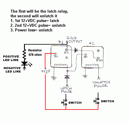

Put it together and you get this.

Thanks for the info, very through,
...so the only way to do this is with two switches for each light? Guess I won't be using that switch after all...
Also how is that diagram any different that yours other than the added LED info?

The only way to use push button switches and bosch style relays is the way above.
If you want to get more invovled you can do it with latching relays, flip flops, microcontrollers, etc.
