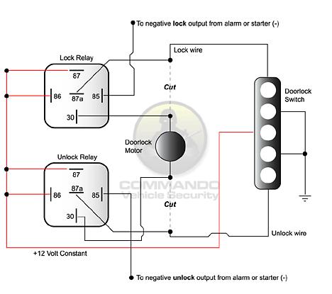

Posted: August 05, 2007 at 7:02 PM / IP Logged
adding door lock switches -- posted image.
will this diagram work?
Posted: August 06, 2007 at 3:51 AM / IP Logged
Yes but you STILL don't need the relays!!
Instead and refer to that very good diagramme you showed, take alarm outputs GREEN/ black and blue/black (30) to ground of switch,  (shown coming from terminal 30 on relays), take switch connections shown coming from 87a to motor(s), take power supply ( marked +on switch) from purple PURPLE / black after the fuse which joins them (which should be 15 amps.
