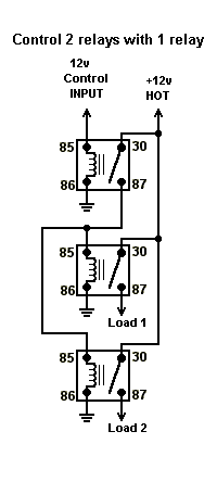

If you are using standard Bosch style relays you will not be able to get away with driving two relays with a 200mA signal.
You would be best off to either use one relay to drive the other two, or use the first relays output to drive the 2nd relays coil (if the output is 12vdc).

hotwaterwizard
Silver - Posts: 1,350
Joined: December 11, 2003
Posted: August 22, 2007 at 8:47 PM / IP Logged
Great Idea Kevin!
I think that would be a great solution avoiding overload and prevent Frying the control power supply or transistor.
A couple of transistors could do also do the job.

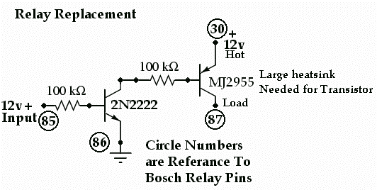

hotwaterwizard
Posted: August 22, 2007 at 9:23 PM / IP Logged
relay coil load? -- posted image.
John DeRosa (Hotwaterwizard)
Stockton California
When in doubt, try it out !

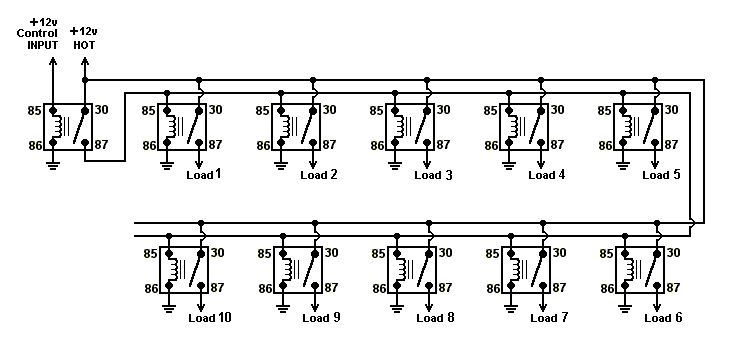

hotwaterwizard
Posted: August 22, 2007 at 9:41 PM / IP Logged
There are many options with this way of controlling multiple Relays
