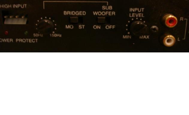

my woofer is a mutant nw1250sb 12inch 700w max 4ohm
my amp is set up as follows
boss sub -- posted image.

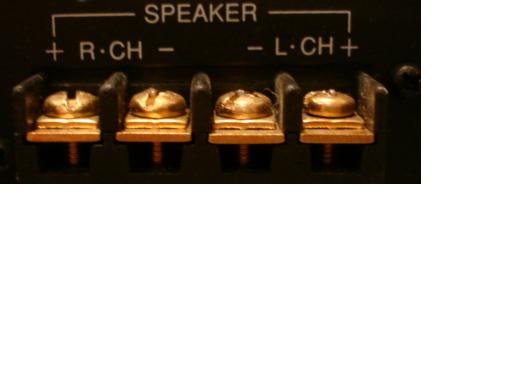

and my speaker terminals look like this
as you can see there is no print to show the bridged output!
so shall i use the outer two ie r+ and l+ and if so, the speaker - goes to witch one

Not getting on anyone's nerves at all, I just wanted to make sure you weren't gonna blow anything up! boss sub -- posted image.
Your woofer is single voice coil, so this makes it MUCH easier.
Since there is no manual, and there is nothing printed to say so ON the amplifier, I'd use the two outside terminals on the amplifier. (the two positves) You won't break anything doing so, and I can pretty much guarantee that's the bridged mode, as with the two terminal in the middle being negatives, they are common inside. This means you HAVE to use the two positives, and the "bridge" switch inverts one of them.
Connect the woofer positive to the amplifier R+ terminal, and the woofer negative to the amplifier L+ terminal.
You'll be fine.
