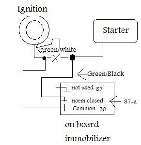

So i was lookin on here and saw how to wire up the starter kill with a realy and it seemed really simple, but then when i grabbed my install guide for my alarm it showed a different way of doing it (i think).
viper 5000, ’89 s10 blazer -- posted image.

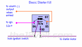

I used the basic starter kill on this site ( norm closed) as my guide.
So before i start cuttin and joining stuff, i wanted a bit of verification as to what i should do.....    Thx
