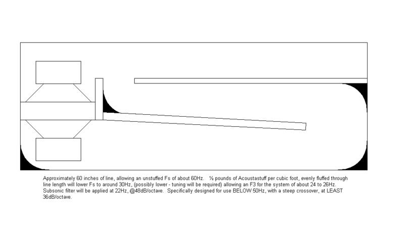

True bass horns are not practical in the car - they're just too big for any respectable extension.
I am curious to know why you won't try TL "again", until you see a "confirmed" design... Have you done a TL in the car before? Did you achieve the desired results? There's your confirmation. But if you want more confirmation, I have one in my car right now, and the results are better than I'd actually hoped for. Following are a few photos of the finished product, and the construction.

You got me on th e rose 18's,i remember the 18 days but not the rose .Did M&M produce?That tline there has a 12 in it?and that diagram is not your actual design right?i see two woofers in design.?%What does it sound like?grabbing low real good?What kinda car?looks like mercedes taillight.Im interested in your box if that is fitting inside a trunk.On the Db thing,Top fuel dragsters produce 170 db in between the cars ,open air.I thought the shuttle was way lower?Is o.s.h.a. still on top of the crank it ups?I hear BABB might be going out of lewisville ,tx doing Marine.I saw "BABB TO THE BONE"in like 1987,A 69 camaro with 56 six and one halfs on a 225HCCA had no pressure really but from a distance some awesome soundQ.Appreciate the Reply.You resider in tx2?

That there is latest from Benz, Der Civic Benz. Yep it's dual loaded with TC's, and yep it plays real low, and real pretty. The whole car sounds damn fine too. Check it out
