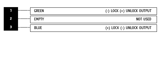

I never like this kind of transistorised outputs. The outputs changed polarites (reverse polarity) if you want to call it. They can cause problems on some of the oem doorlocks system.
To check if they are still functional, I would use a relay pin 85 to constant +12v, pin 86 to green (-), press lock button, it should click.
Connect pin 86 to blue (-) to check  the unlock function. If they work this way, then the rest is easy.
keyless entry, 2001 integra - Page 2 -- posted image.
