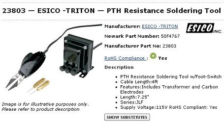

This may be overkill, but we use this one for work quite a bit. Have to be careful with the lighter gauge wire, or just run it on the low setting.

I put on a brand new set before I started the last car. They still look brand new. If you're careful and have a "fire resistant" surface to place them on between soldering, you should get a lot of soldering out of a set of tips. I worked around some "not too careful" co-workers and these tips last until they accidently drop them on the floor. The other   issue with this solder tool is the tips accumulate melted plastic/rubber insulation and need cleaning often as this effects the connection.
