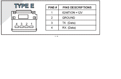

Here is the pin configuration for 2007 ford explorer.
   2007 explorer 1100f -- posted image.

thanks bro.. and my domelight slowly fades out when the doors are locked, which causes the alarm to bypass the doors i believe, how can i change that?  And any wiring diagram for my windows by any chance so i can hook up the 530T? Thanks
