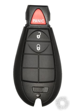

This is a Remote Starter with Keyless Entry Pictorial for the 2010 through 2012 RAM 1500 pickup truck.  This vehicle
was a 2012 with automatic transmission, Hemi V8, regular key and no Factory Alarm system.   Probably one of the easier
vehicles to upgrade.   By regular key, we mean the plastic FOB / Remote assembly.  Photo below :

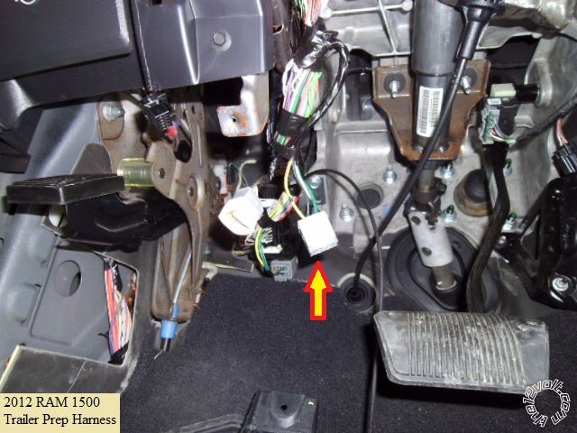

Please note the indicated Trailer Plug as this will be used during the install.
Wires :
Below is a photo of a convenient +12V constant power source found at the Trailer Prep Plug :
2010-2012 Ram 1500 Remote Start Pictorial -- posted image.

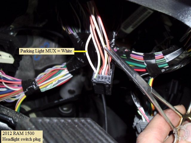

By reaching up behind the Headlight Switch, you can release this connector for the Parking Light MUX wire :

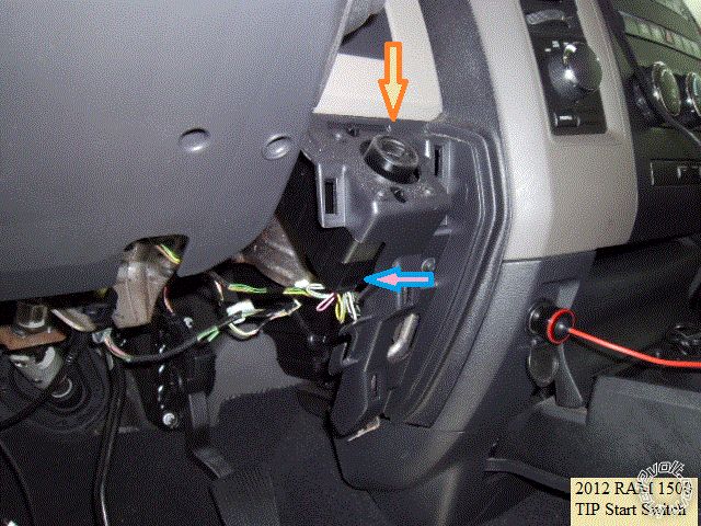

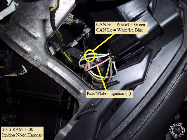

The Ignition Node Harness can be accessed without unplugging the connector.  Photos below :

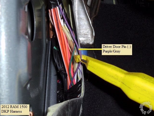

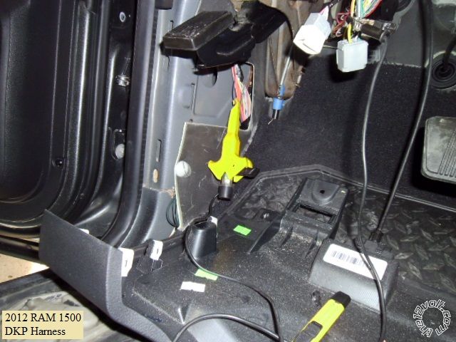

The Driver Door Pin wire is found in the DKP area.  Pictures follow :

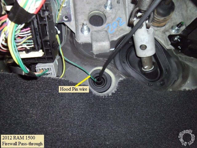

Firewall pass-through for the Hood Pin safety wire can be found in several places.  The photo below shows a convenient
place :

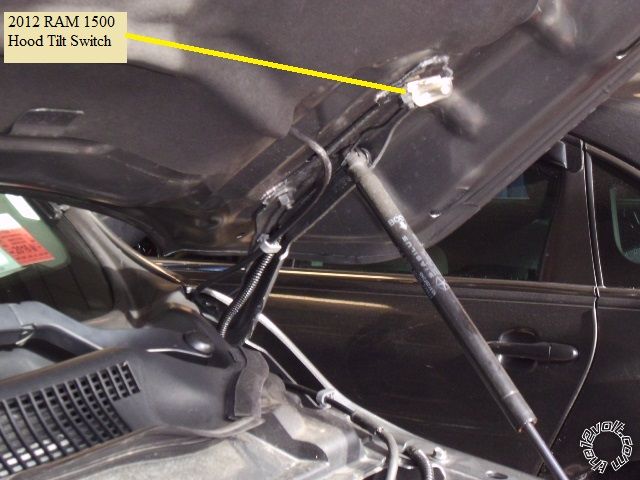

Rather than use the U1272 kit supplied hood pin ( and drilling a hole in the truck ) I used a tilt switch mounted to the
hood hinge as pictured below :
