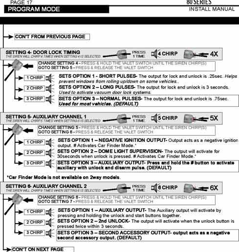

Ok one more question about this install. The Ultra Start 1280 installation manual gives the following regarding programing an output for additional (-)ignition output. The description is confusing to me. From the manual as depicted below, Setting 5 - Auxiliary Channel 1, Option 1 states:
"Output acts as a negative ignition output. # Activates car finder mode."
If the RS output is providing (-) ignition output anytime the RS is active how can this output provide any other function at the same time. For example if the RS has car running and thus the RS is providing (-) ignition for my relay what happens when the # button is pushed on the remote control.
The first statement below is a description of the Auxiliary output from the remote installation manual and the second is the programming instruction for this output. This is NOT a 2 way model:
WHT/VIOLET Auxiliary Output 1/ Programmable Output Auxiliary output when the # button is held. Programmable to (-)Ignition/ Car Finder and Dome Light Supervision with Car Finder. (Car Finder and Auxiliary 1 are not available on 2way models)
98 altima gxe isolate accessory circuit? -- posted image.

Mike M2
Platinum - Posts: 2,652
Joined: June 29, 2005
Posted: December 21, 2008 at 1:08 PM / IP Logged
Hopefully someone else here can help as i am not familiar with Ultrastart. I'm not sure what car finder mode even is...
