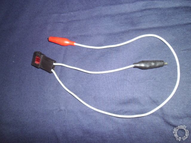

You could check the 211HV's Horn output to verify it is indeed working. Easiest way is with a LED test light
but a DMM will work also. Set the DMM to 20V DC, Red test lead to a +12V constant source and Black test
lead to the 211 HV H1/12 Brown wire. The DMM will go to +12V when the system tries to beep the horn. You
can use the same DMM set up on the truck's Dark Blue Horn wire. Every time you press the horn button, the
DMM should read +12V ( and the horn will sound ). As a final test, you can use a jumper wire from chassis
ground to briefly touch the Dark Blue horn wire. That should also beep the horn.
