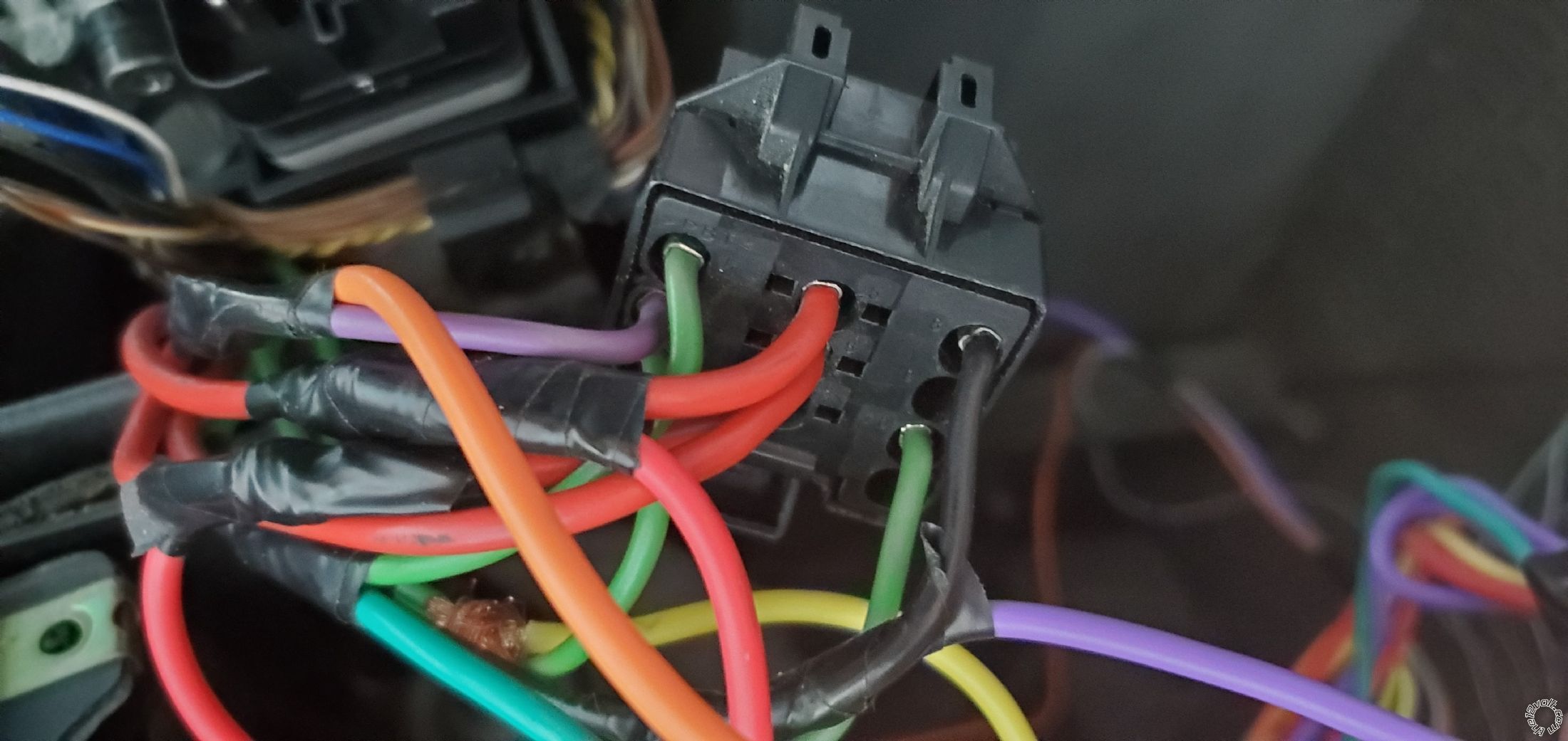

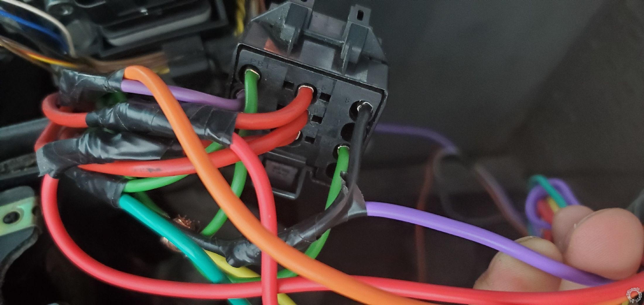

Ignition switch is connector X33

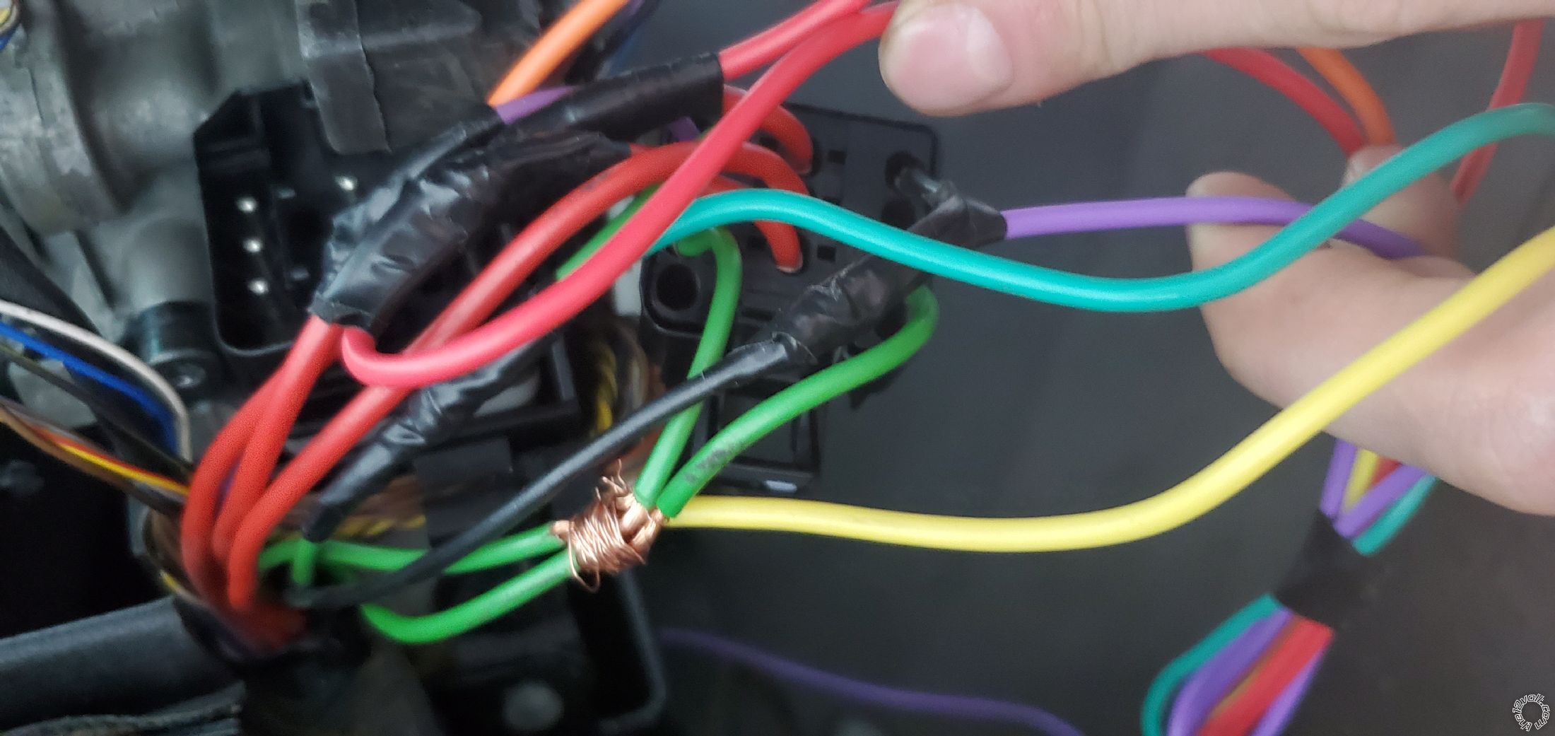

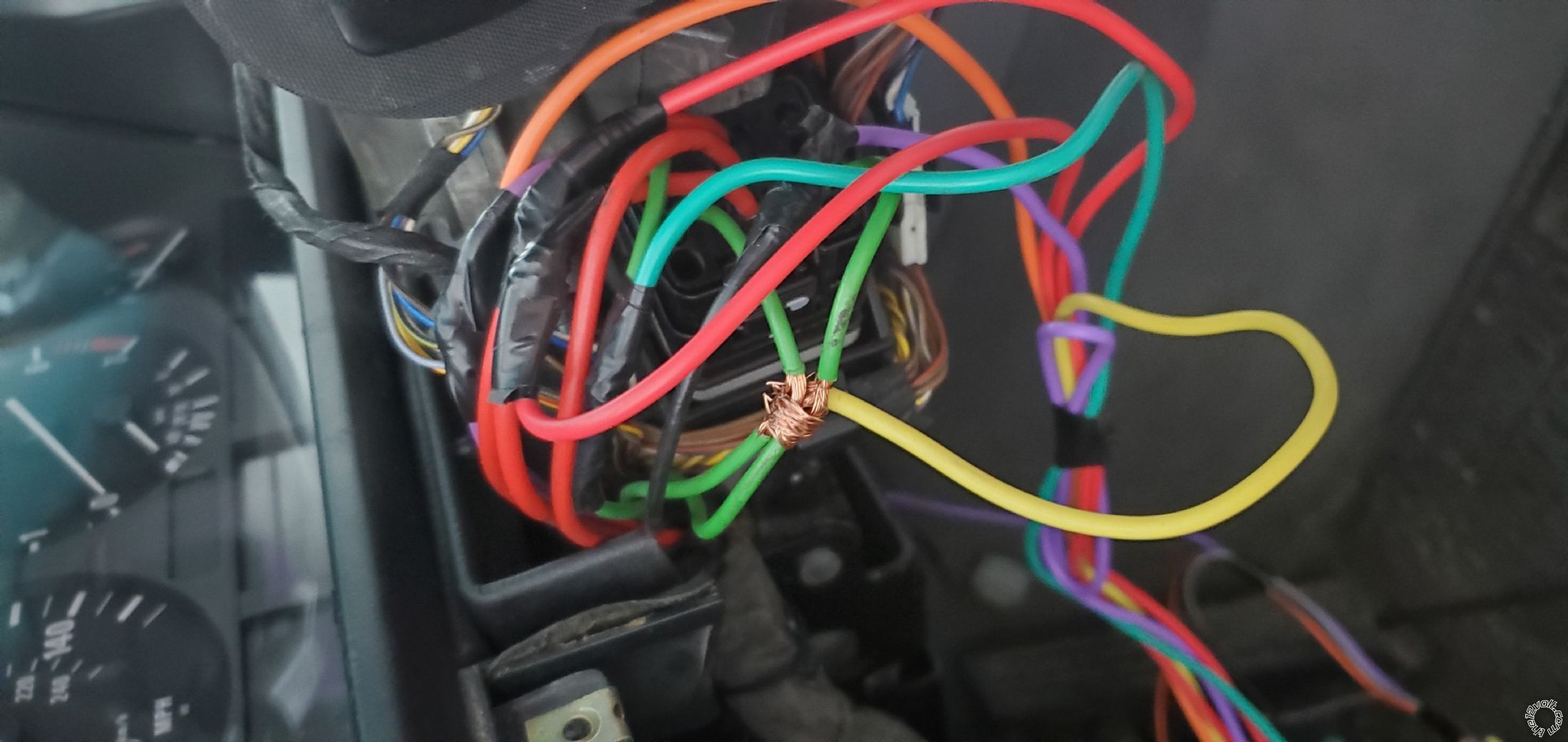

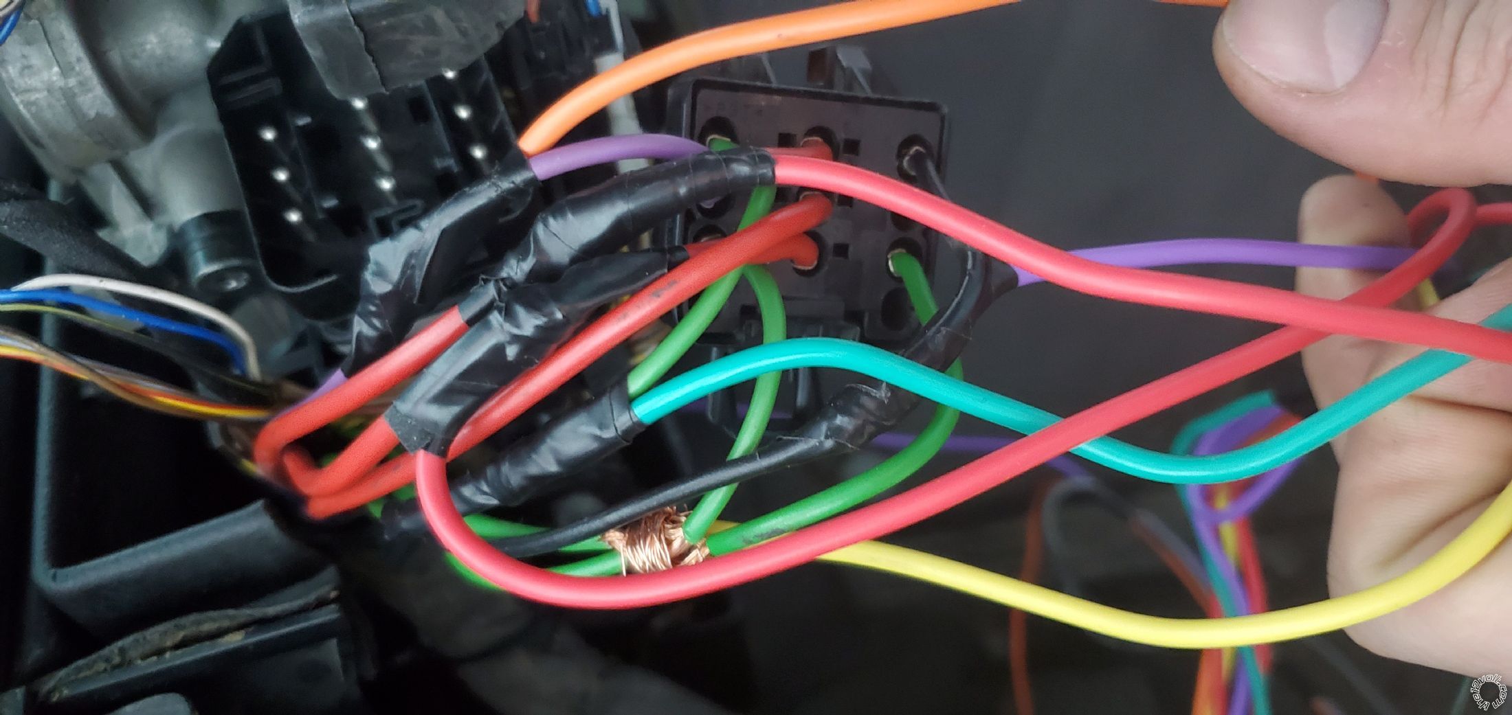

My ignition switch connections:
Pin 1, 3 and 10 are green wires that I understood are all ignition.
I connected the 2 of them together to the yellow (ignition) wire from the module. I connected the third one to thr "5th relay" wire having set the jumper to "ignition 2" previously.
I could've powered the first two green wires separately, but I didn't bother.
You can actually connect all 3 ignition wires together and it will still work fine.
Pin 2 is a purple wire I understood to be accessories, so I connected it to the orange wire on the module.
Pins 5, 6 and 7 are all red power wires, 12 volts constant. I spliced wires on pin 5 and 7 and connected them separately to 2 red wires from the starter module. I left red wire on pin 6 intact.
Pin 8 is a black starter wire, so I connected it to the purple starter wire on the module.
Pin 9 is empty
Pin 10 I already covered
Pin 11 is empty
Pictorial Remote Starter 1998 BMW 528i E39 -- posted image.

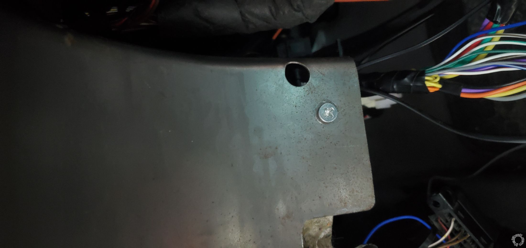

First pin is ground, pretty simply. You can drill a hole and put a screw or first one already existing.
I drilled an extra hole.

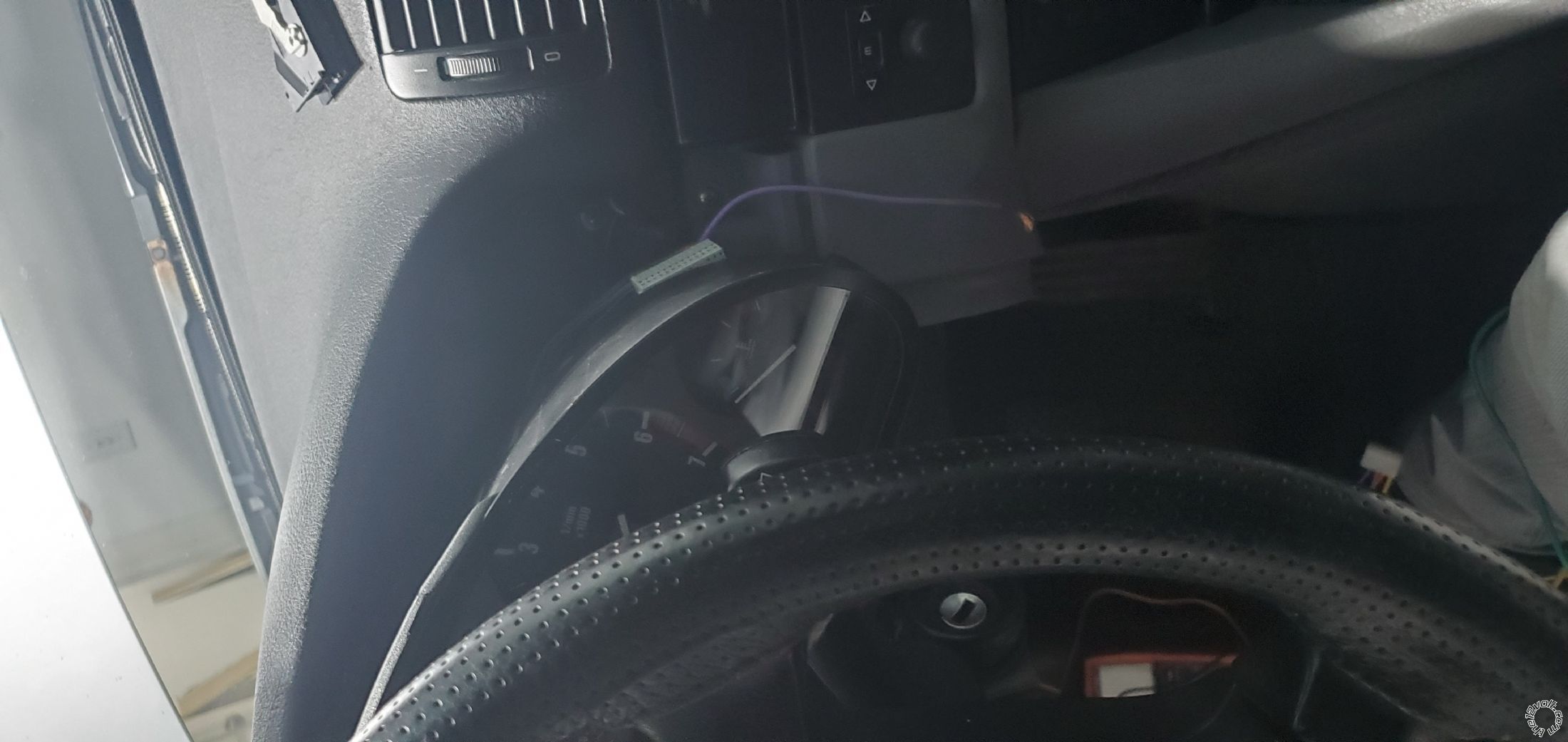

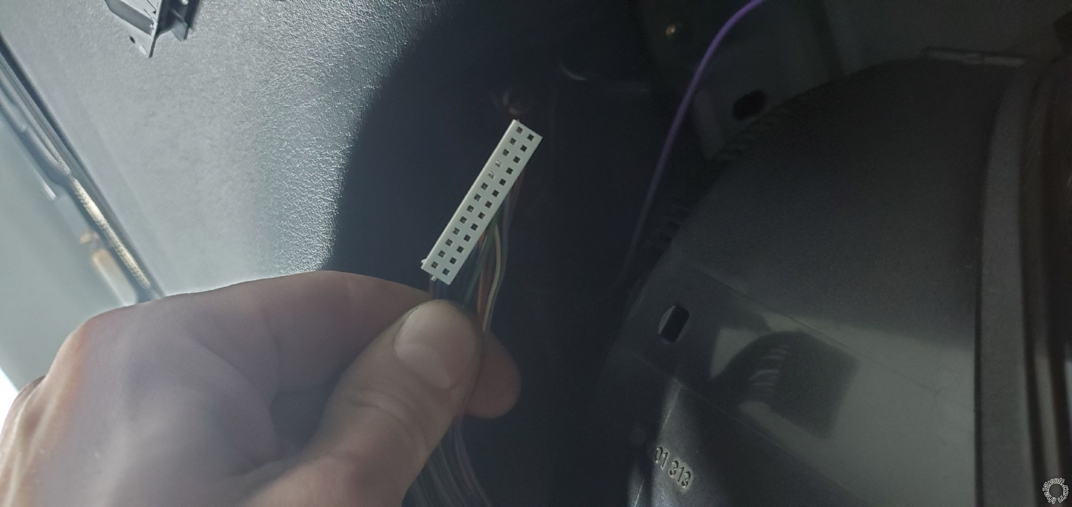

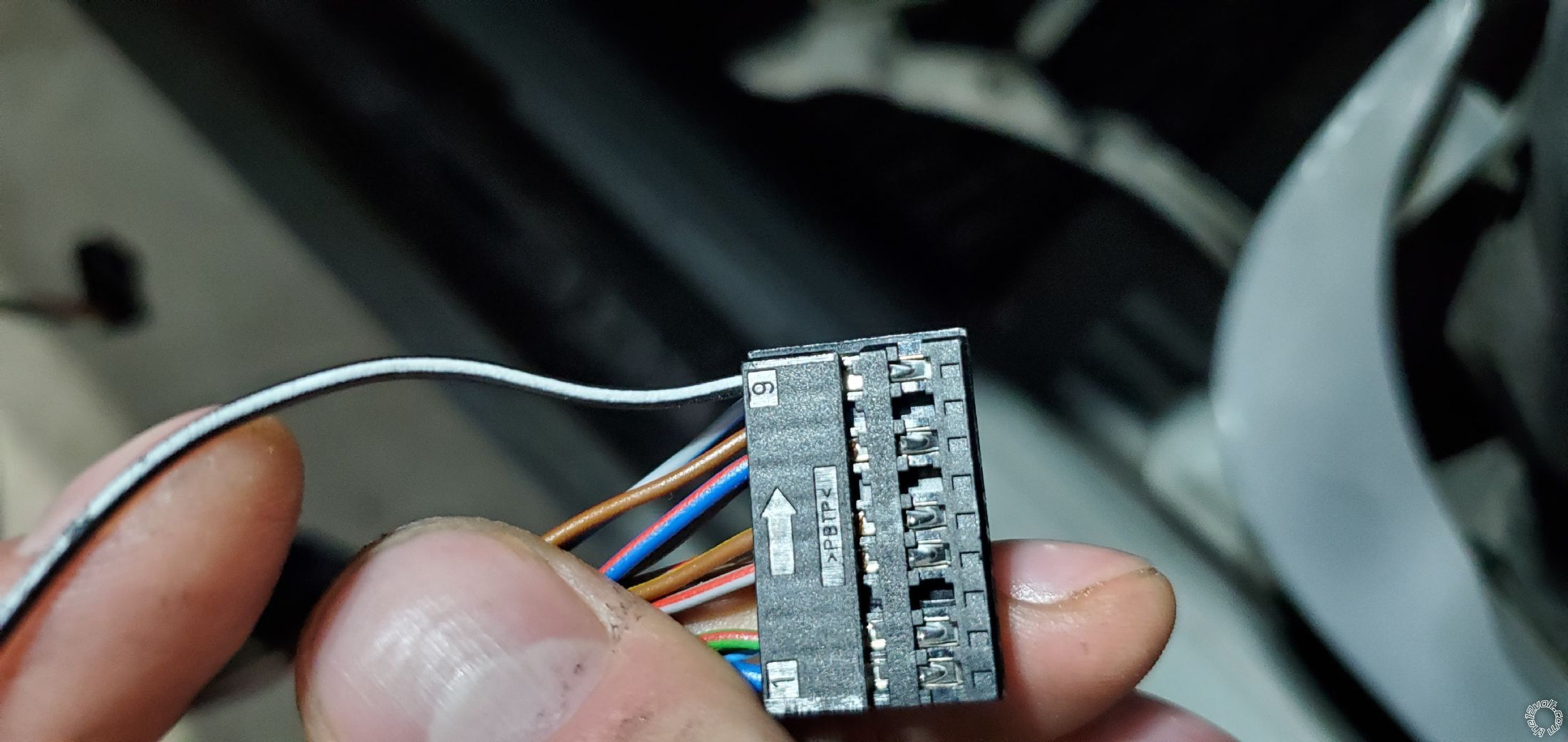

Now pin 2 on this remote is for tach wire.
Looks.like lots of remotes have the option of wireless setting, including this one. However I used a wire.
Lots of tutorials recommend running your wire into the diagnostic post under the hood. I don't think this is very practical or needed.
Just use pin 6 on Connector X11175. It's the connector on your right side of the display.

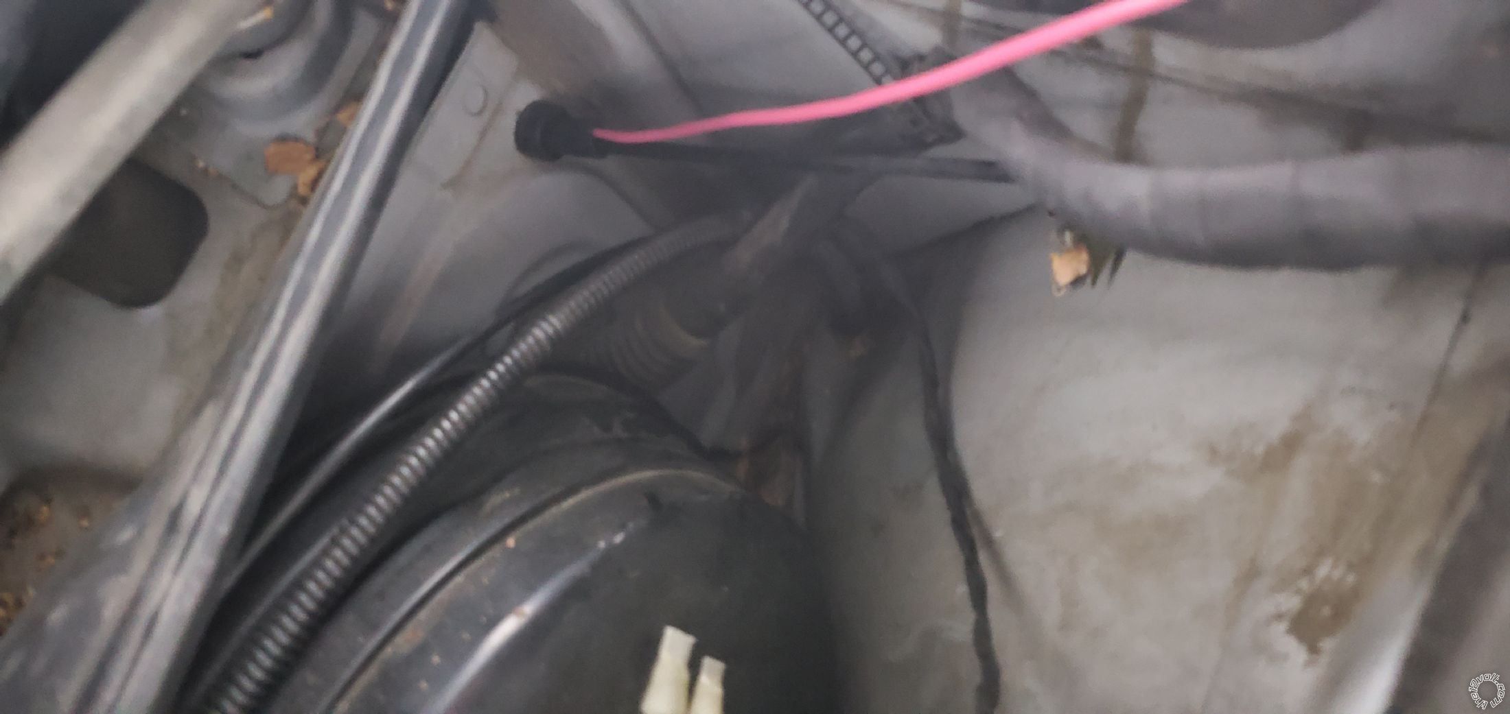

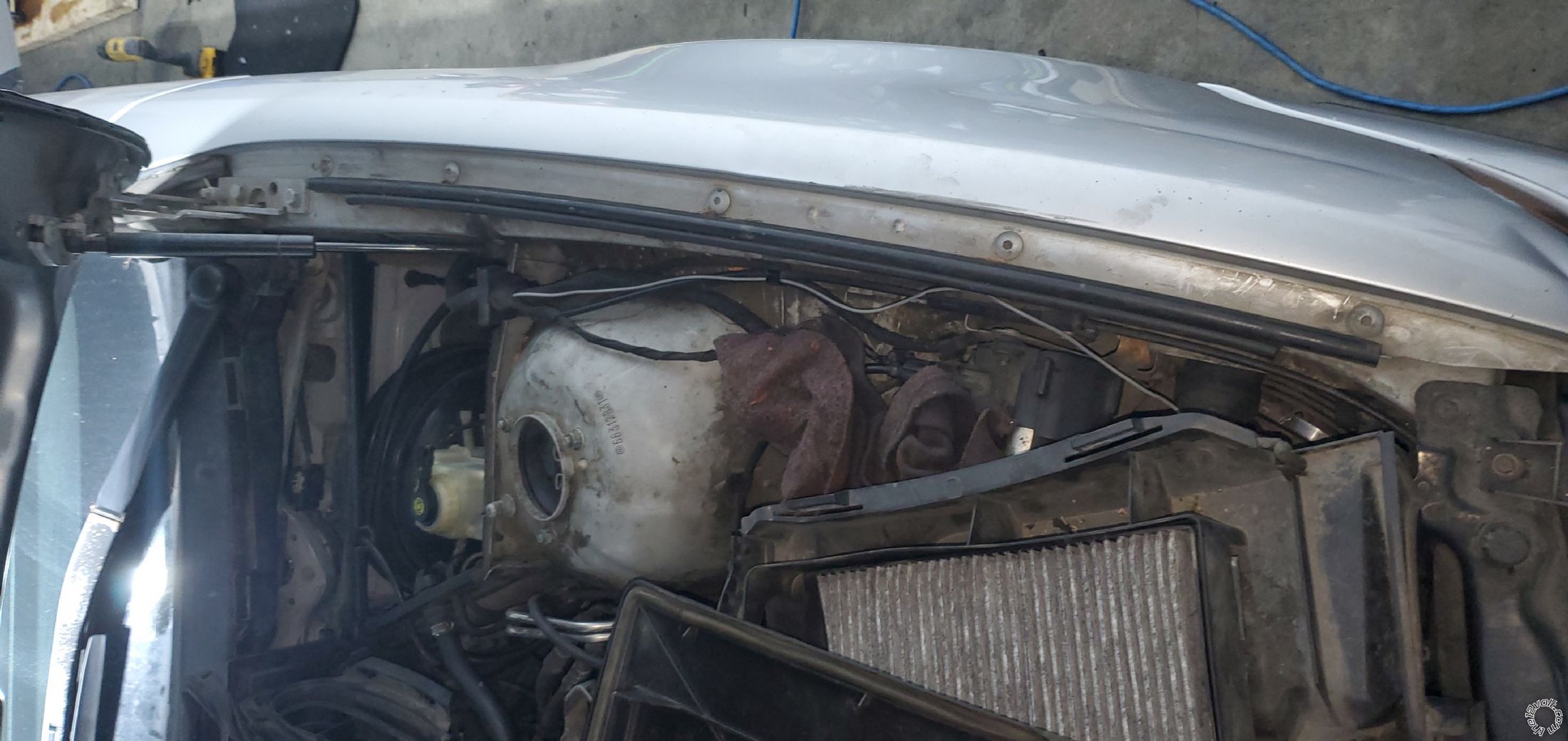

Now we move to the next wire, hood pin.
It's needed for programming the module so I installed it. If your vehicle was started from the remote, it will shut off if you open the good. The vehicle also won't start from remote if the hood is opened.
You run the wire under the hood like this Pictorial Remote Starter 1998 BMW 528i E39 -- posted image.Pictorial Remote Starter 1998 BMW 528i E39 -- posted image.Pictorial Remote Starter 1998 BMW 528i E39 -- posted image.

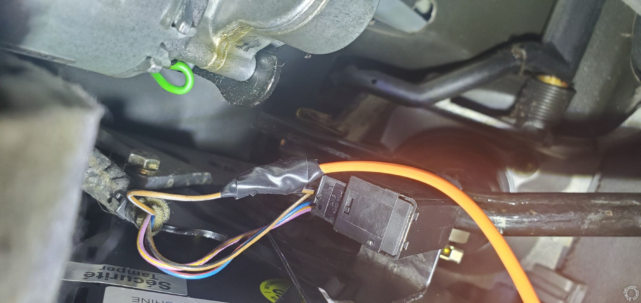

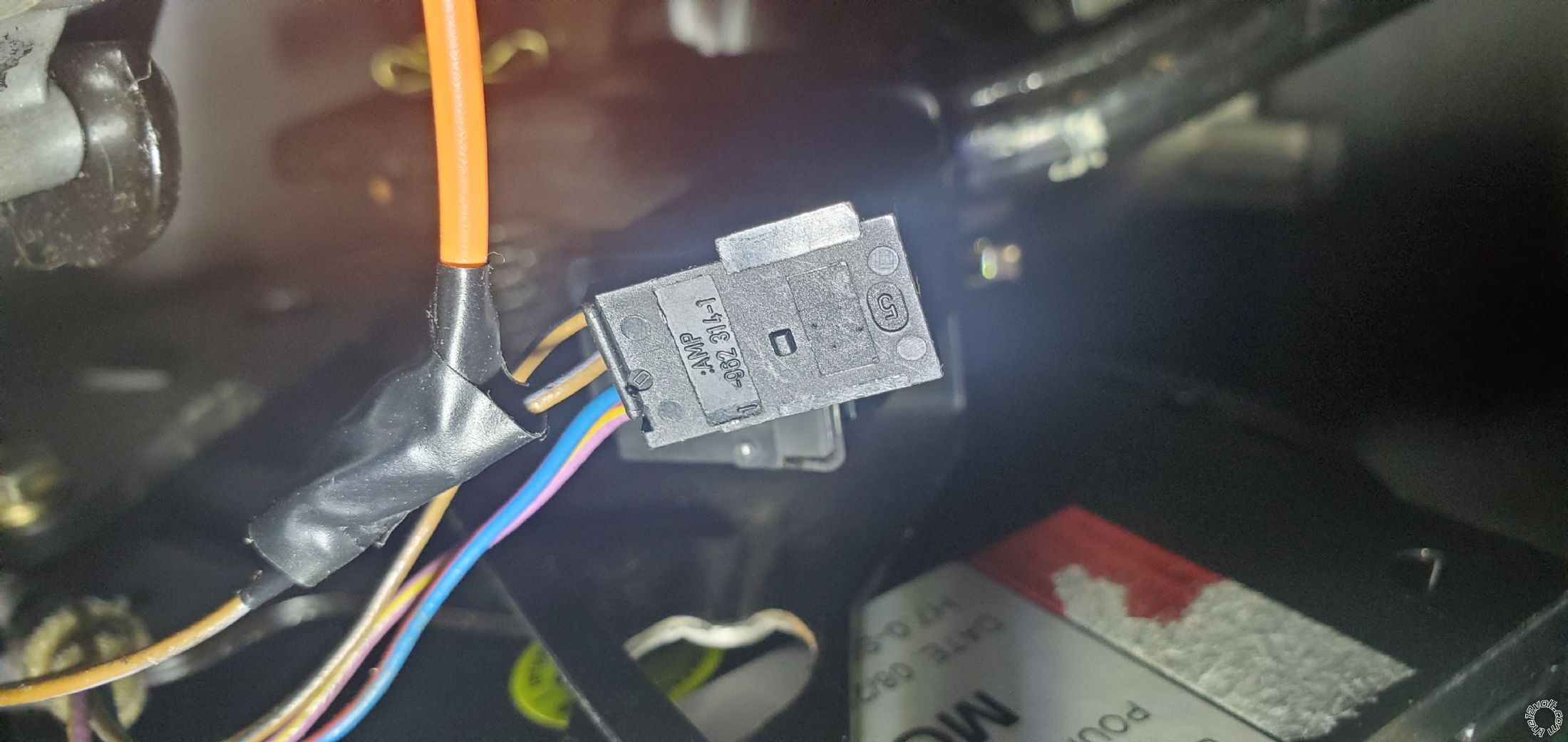

Moving on to break pedal wire.
It's grey/brown color. When the car is started, pressing the brake pedal will turn it off.
It's also needed to enter programming mode. When entering the programming mode, turn the key the first position, otherwise the break light will not work.

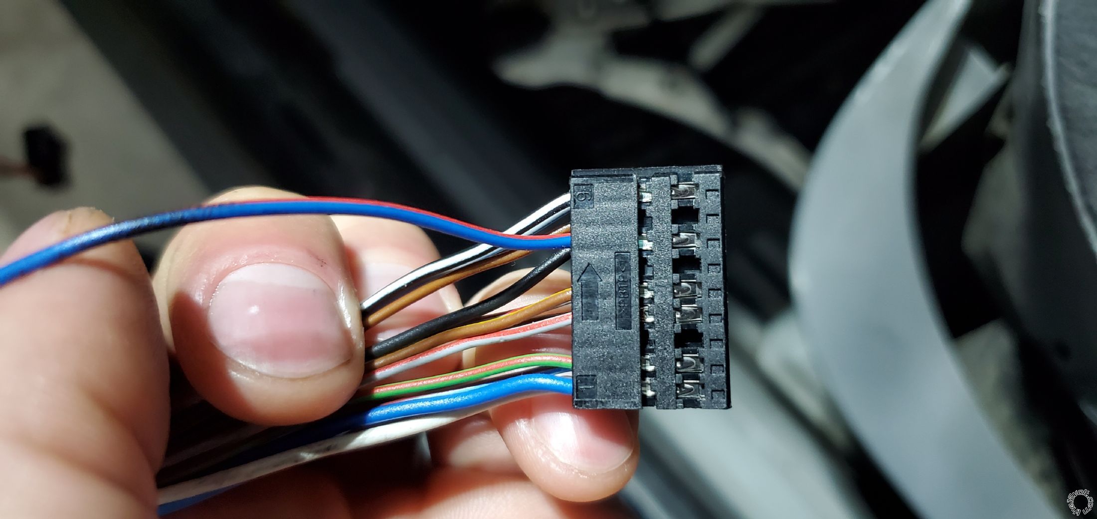

Now the last 12 pin connector.
Pin 1 is the blue wire on my remote.Pictorial Remote Starter 1998 BMW 528i E39 -- posted image.
You gotta connect it to the grey wire at the trunk switch. Simple.

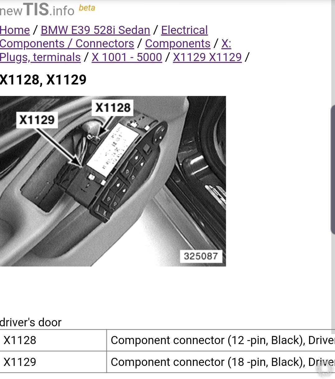

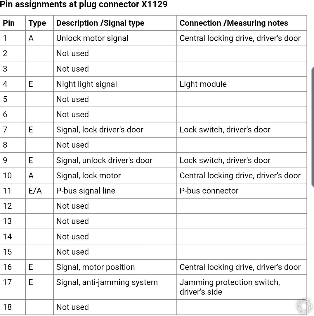

Pin 2 and 3 are lock and unlock wires. They can be found inside the door or in the footwell area. Inside the door it's connector X1129
Pik 7 is to lock the doors, pin 9 is to unlock.

Blue and red is to lock, black and white is to unblock Pictorial Remote Starter 1998 BMW 528i E39 -- posted image.Pictorial Remote Starter 1998 BMW 528i E39 -- posted image.Pictorial Remote Starter 1998 BMW 528i E39 -- posted image.
