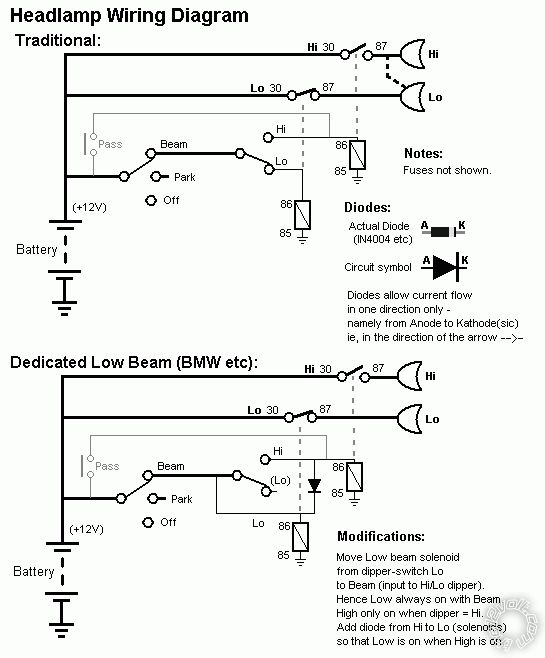

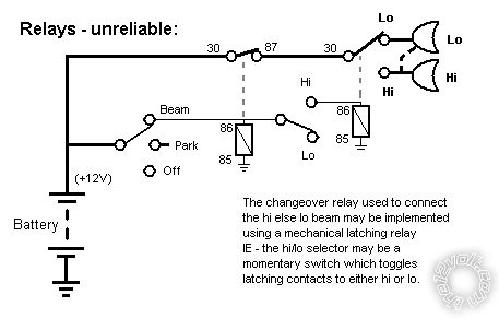

Here are a colleague's diagrams that cover what I've discussed...
All circuits use 2 relays.
The first shows a changeover relay being used for the hi-lo selection. IMO this is unreliable (meaning no redundancy - a single failure can mean no lights).
using relay to power up high beam -- posted image.
The next shows the above using identical SPST relays that could be swapped if it's the most desireable beam that fails (ie, usually low beam - replace failed lo-beam relay with the hi-beam's).
Also failure of one relay does no effect the other beam.
It shows the TWO topologies for a 4-headlight system - namely dedicated lo-beam or combined hi&lo-beam for one pair (and dedicated hi-beam for the other pair).
The upper "Traditional" depicts H4 type hi-lo bulbs and the dashed line between lo & hi means the hi-beam power (for the hi in the "Lo" which should probably be called outer or upper beams). (It can also take me a while to decipher his diagrams!)
The lower is the (modern) equivalent where the beams are a dedicated lo-beam, ie, a single filament bulb etc. They remain on when the hi-beam is on. (This does not occur in dual-filament bulbs like H4 as they would overheat, though they may both light in "flash" (passing) mode...)

Hopefully you'll see how the "unreliable" wiring to the RHS of the first relay (RHS of #87) is the same as your last diagram.
The first relay is merely the "beam" power - that relay is on whenever "beam" is selected, though it could be a hi-current switch (though in that case, the hi-low is probably also a switch since it's bad design to use a high-current switch followed by relays; though I have seen that used in some vehicles!)
