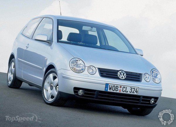

Good day.does anyone have the alarm wiring info on this car.can't find it anywhere on the net.Howie what is this vehicle called in the UK?VW Polo 2005 alarm wiring info -- posted image.
