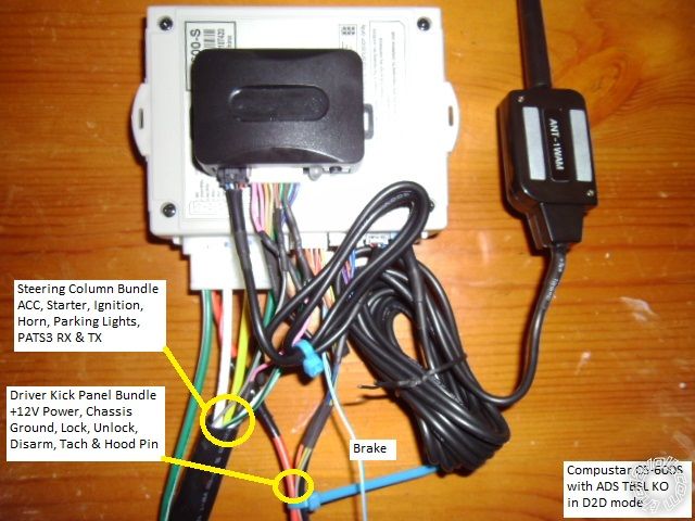

For this install, an ADS TBSL KO was chosen for it's reliability, ease of programming and D2D compatibility with
the Compustar CS600-s R/S unit.  Below is a photo of the preliminary bench prep of the two modules.   All unused
wires were cut to ~1.5 inches and bundled together and insulated with heat shrink tube.

This vehicle does not have "one-touch" starting so running in Tach Mode is deemed best for reliable year round
starting.  This vehicle does not have built-in Anti-Grind so adding this feature should be considered.

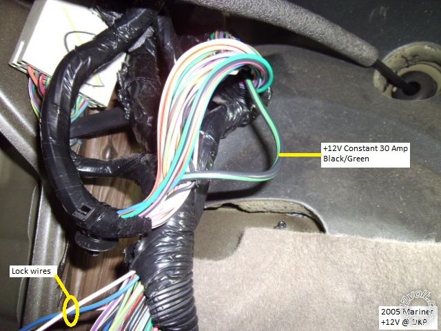

1.  Red  +12V           BLACK/ Green in DKP      *Note 1
2. GREEN / WHITE Parking Lights (+) not used
3. RED / White  +12V   Combined with Pin 1 Red, single wire, fused down to 20 Amps

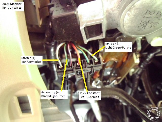

4. White  Accessory (+)       BLACK/ Light Green @ Main Ignition Plug
5. Blue Flex Relay   not used
6. Yellow  Starter (+) Tan/Light Blue @ Main Ignition Plug
7. Green Ignition (+)   Light GREEN/ Purple @ Main Ignition Plug

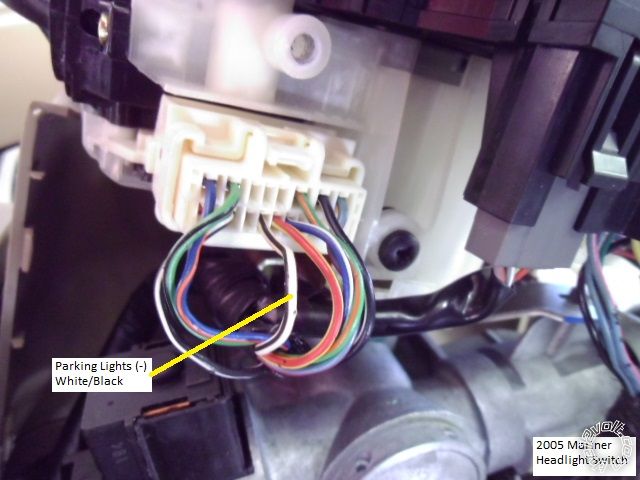

1. GREEN / WHITE  Parking Lights (-) WHITE/ Black in steering column @ Headlight connector

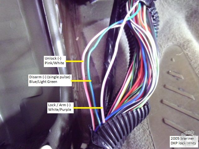

6. ORANGE / White (-)Disarm Output Blue/Light Green @ DKP / door harness       * Note 2 & 4

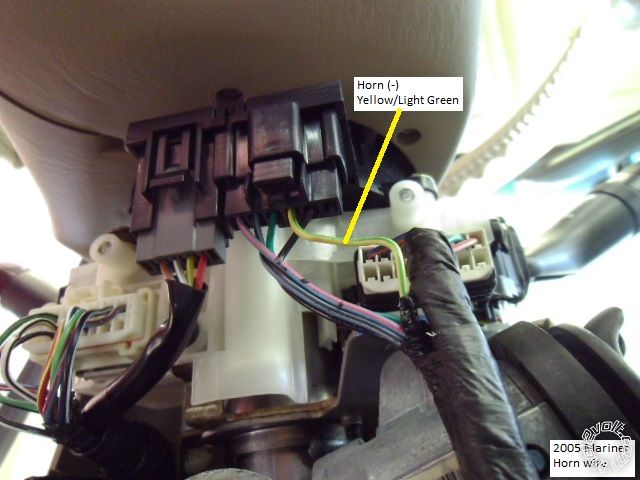

7. White (-) Horn Output       Yellow/Light Green in steering column @ slip ring connector

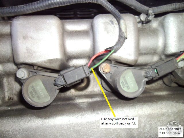

12. Yellow/Black Tach (AC)              WHITE/ Pink @ PCM, in passenger side connector or any Coil Pack or F.I. - not Red

4. Blue (-) Unlock     Pink/White @ DPK / door harness * Note 2
5. Blue/Black (-) Lock           WHITE/ Purple @ DPK / door harness       * Note 2 & 4

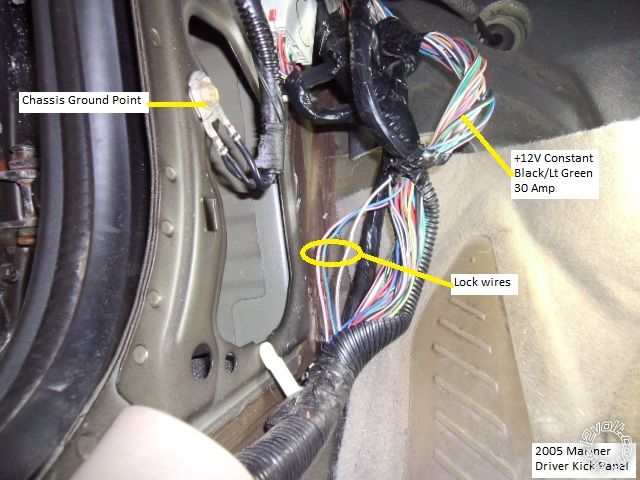

Note 1   While the wire guides list the Red wire in the main ignition connector as +12V constant, it is fused at a mere
10 Amps.  This is pretty marginal for the added R/S and bypass module, especially if using the (+) Parking Light wire
or with an alarm system.  The +12V input wires for the R/S  system were combined into one wire with a single 20 Amp
fuse and connected to the BLACK/ Green 12 gauge wire shown in the photo's.  Running directly to the vehicles battery
is another option.
Note 2  This vehicle has a one-wire door lock system.  Typical installs would use a Direct 451M door lock module
and a 1,000 ohm resistor.  However, on vehicles with the Factory Alarm system it is preferable to use the Pink/White
one-wire door lock wire for Unlock, the WHITE/ Purple Factory Alarm Arm wire for Lock/Arm and the Blue/Light Green
Factory Disarm wire to disarm the system ( prior to an unlock and remote start ).

Note 4   These wires are the key cylinder Arm & Disarm wires.  Test for these wires while turning the key in the driver
door lock cylinder.

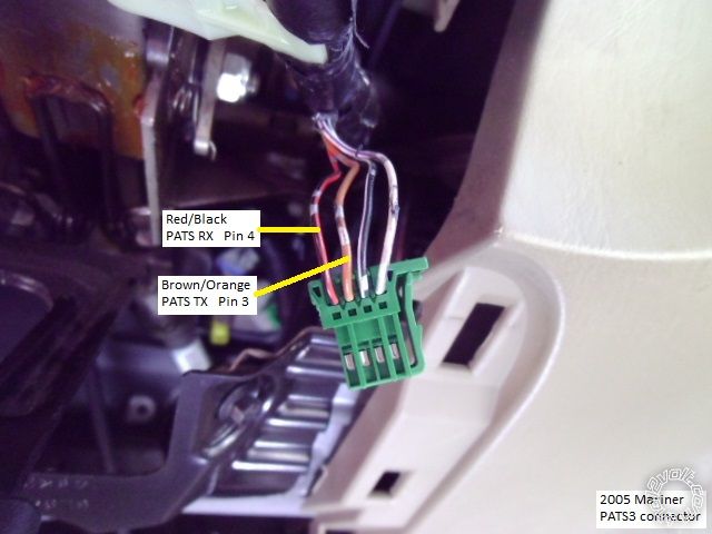

5. Gray/Red        to Mariner Transponder Plug, Pin 3, BROWN / Orange
6. GREEN/ YELLOW not used
7. GREEN/ Red     to Mariner Transponder Plug, Pin 4, RED / Black

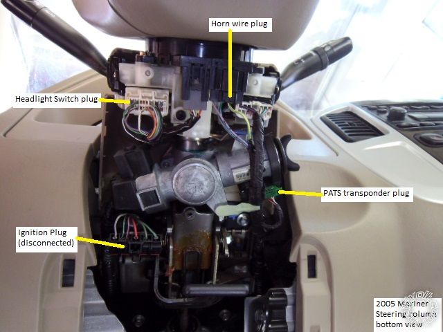

All of the necessary wires can be found in the steering column, the Driver Kick Panel, at the Brake pedal and under the
hood.  Disassembly is straight forward.  The center lower dash panel has 4 snap fasteners and two tabs at the bottom.
The steering column cover is held in place by 3 Phillips screws at the bottom section.  The DPK is held in place by one
plastic nut, two trim poppers and one snap fastener.  Firewall pass through is conveniently found above to dead pedal
in an large, unused, rubber grommet.

Photo 1 -  Driver Kick Panel area ( with plastic panel removed ).   Locks, chassis ground & +12V.
2005-2007 Mercury Mariner Remote Start Pictorial -- posted image.
Photo 2  -  +12V close up
Photo 3 -  Lock / Alarm wires close-up
Photo 4 -  Steering column - bottom view
Photo 5 -  Horn close-up
Photo 6 -  Parking Lights close-up
Photo 7 -  Ignition connector, unplugged, wire side view
Photo 8 -  PATS transponder plug, unplugged
Photo 9 -  Tach
