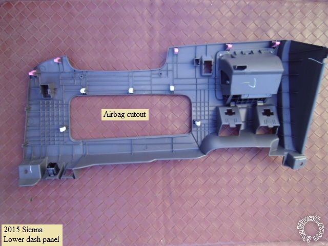

Remove the two 10mm bolts at the lower corners of the lower dash panel, then pull the panel straight back.  There
are 5 retainer clips along the top edge.  See photo below of back-side of lower dash panel.
2015 Toyota Sienna H Key Remote Starter Pictorial -- posted image.

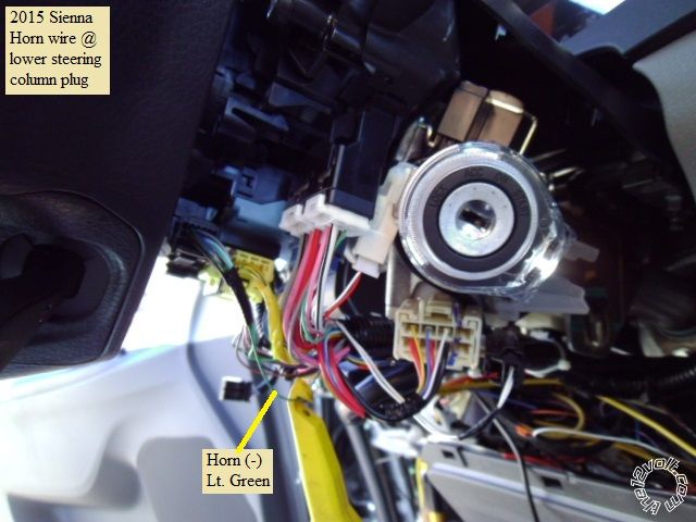

This is a photo of the Horn wire found in the steering column at the clock spring plug.

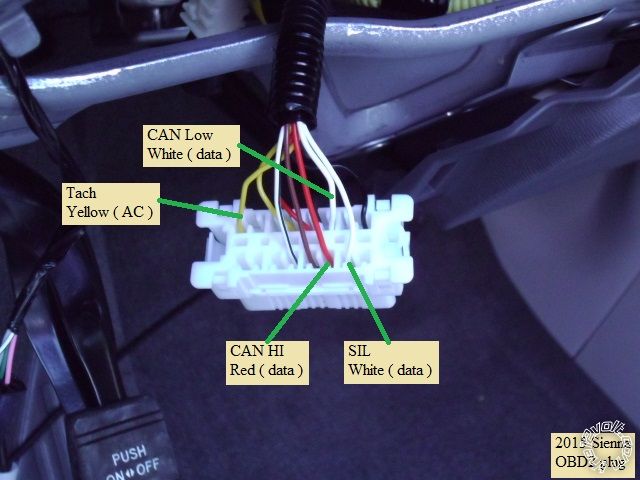

Next is the OBD2 connector :

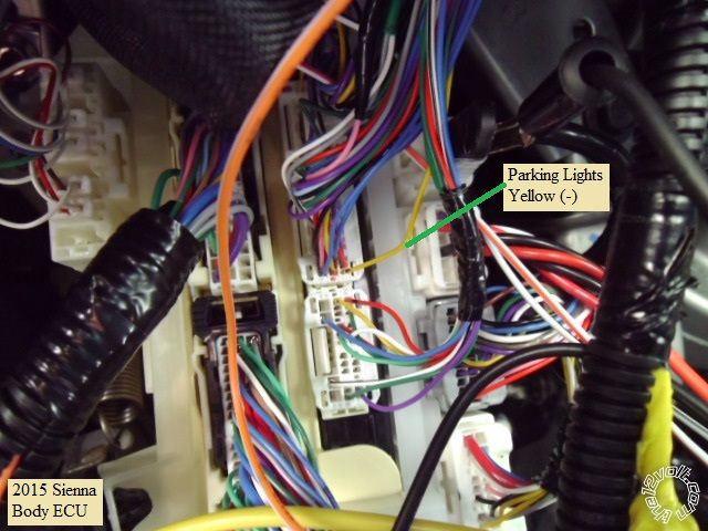

In the exposed dash, to the left of the steering column, is the Body ECU and the Tire Pressure Warning ECU :
Here are the important wires in the Body ECU :

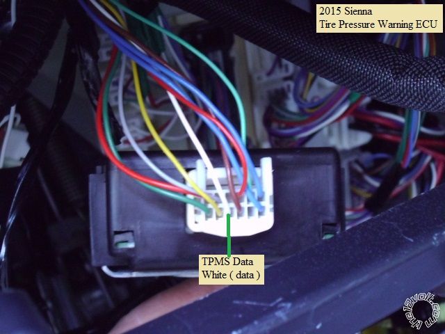

The hard to locate TPMS wire is in this Tire Pressure Warning ECU connector.  Use a deep 10mm socket with a long
extension to remove the mounting bracket nut and pull the TPW ECU towards you.

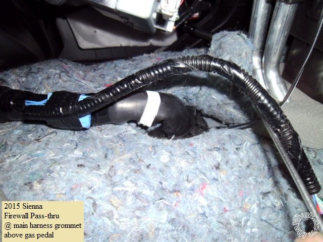

Firewall pass through for the hood pin wire can be found at the main engine harness grommet, pictured below :

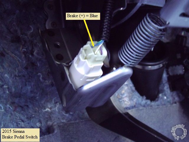

While not needed ( provided by the bypass module ), here is a photo of the brake wire :

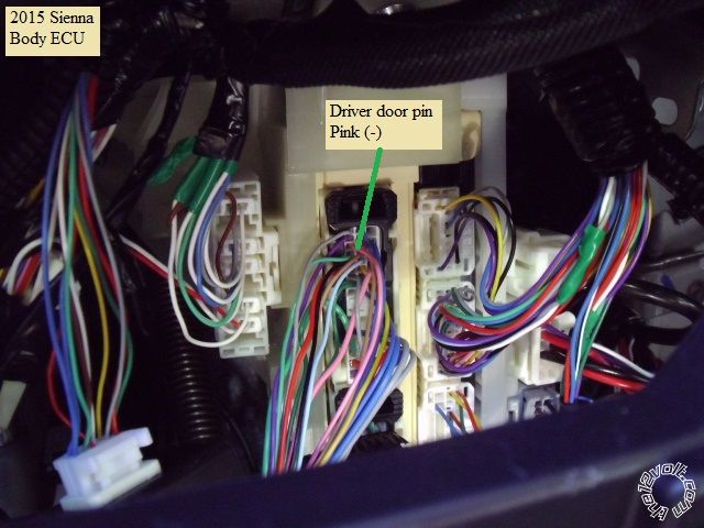

If your Sienna has Auto Headlights, be forewarned that with a certain sequence of events the battery can be inadvertently
drained.  If the van was parked with the headlight switch in the Auto position and the van was remote started at night and
then remotely shutdown, the headlights would remain on until the battery was drained.   Connecting the R/S (-) Rearm
output wire to the driver door pin would make the van think a door was opened after the engine was turned off and
the headlights would be turned off after 30 seconds.  Here is a picture of the Drivers Door Pin wire at the Body ECU :

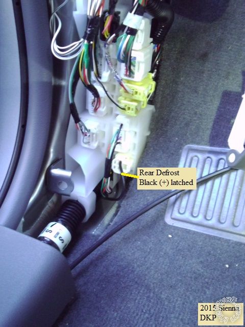

If your R/S system has the capability, here is a shot of the rear defroster wire in the bottom plug in the DKP.  It needs
a high current (+) signal.
