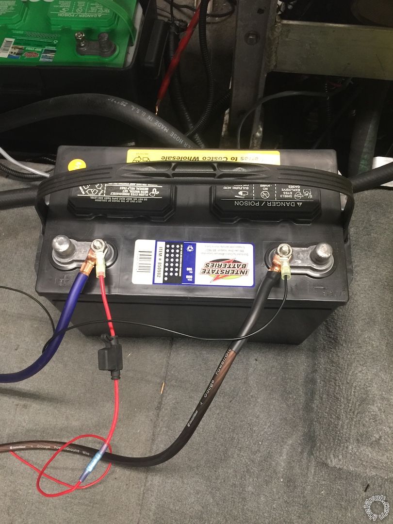

Power/Ground at Battery (Second battery attempt, you can see the first the in background)
Noise in New Boat Stereo System -- posted image.

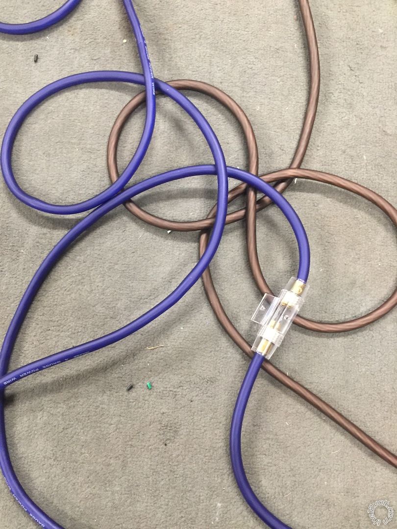

Power/Ground cables (on the floor for now)

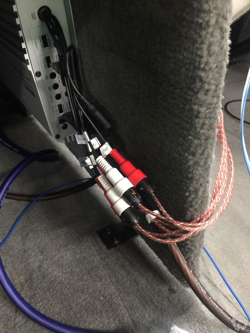

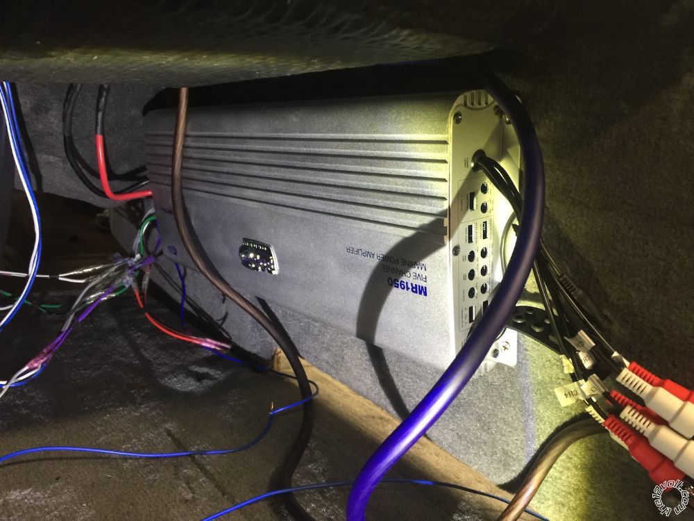

RCAs at amp

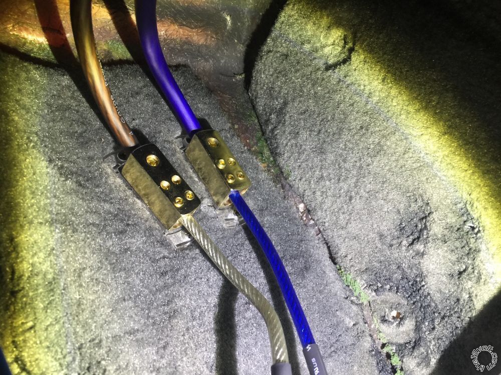

Power/Ground distribution blocks

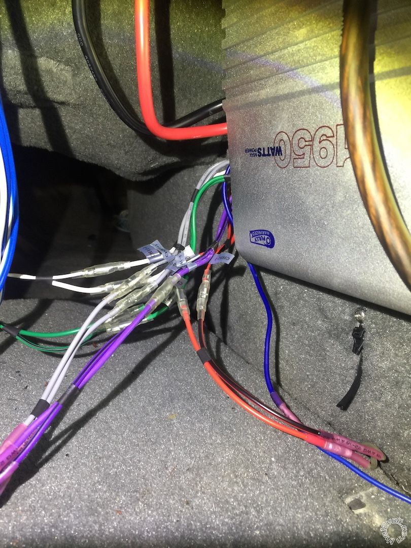

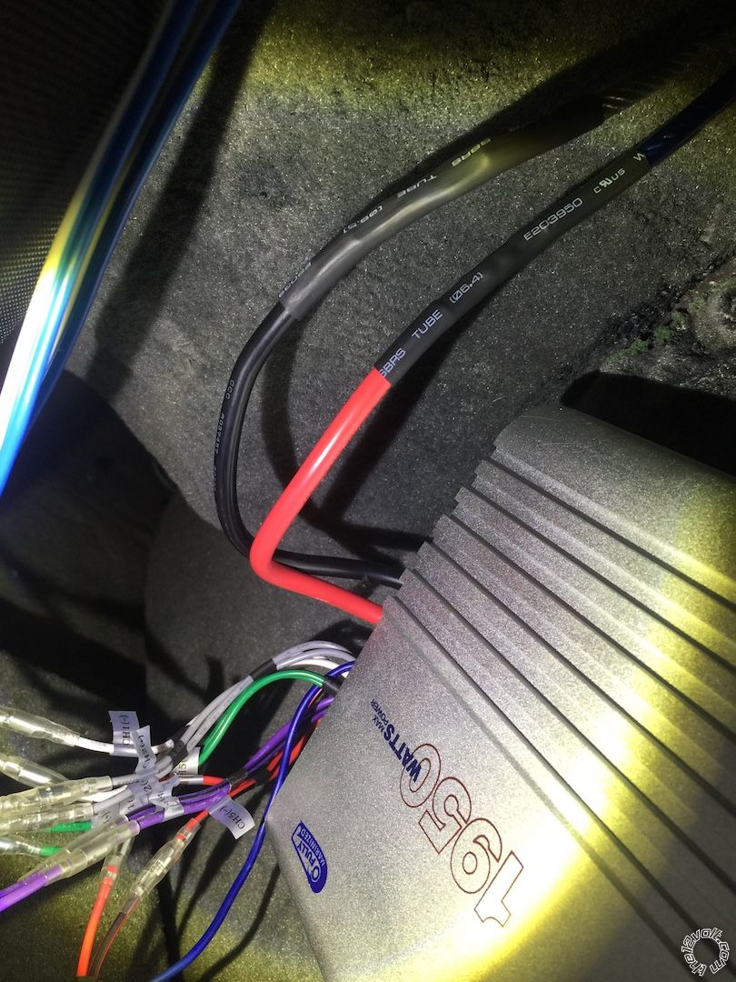

Power/ground at amp
Speaker wires at amp
Amp

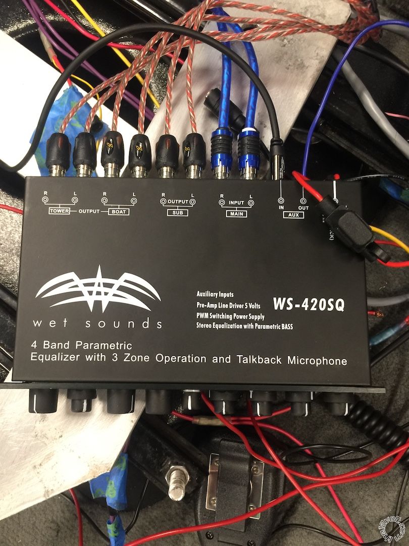

Equalizer

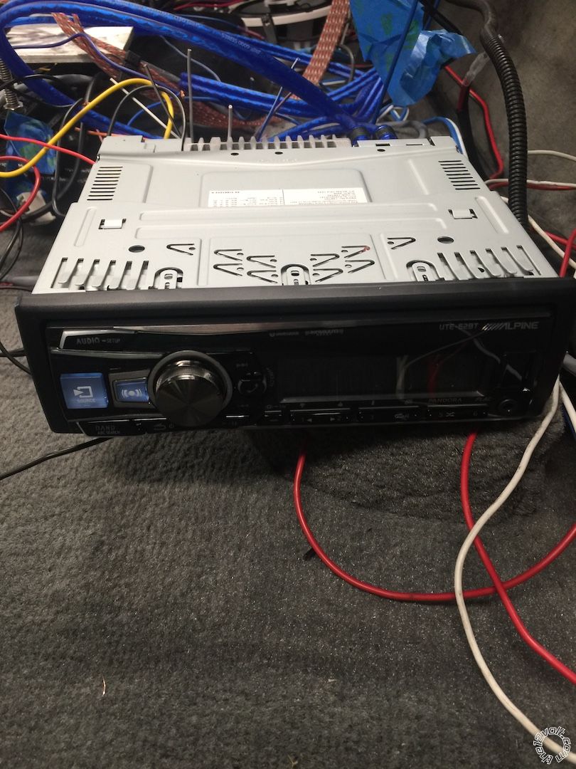

Head unit

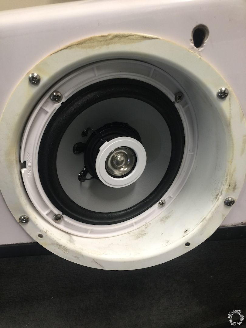

In boat speaker

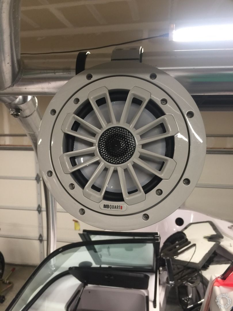

Tower speaker
