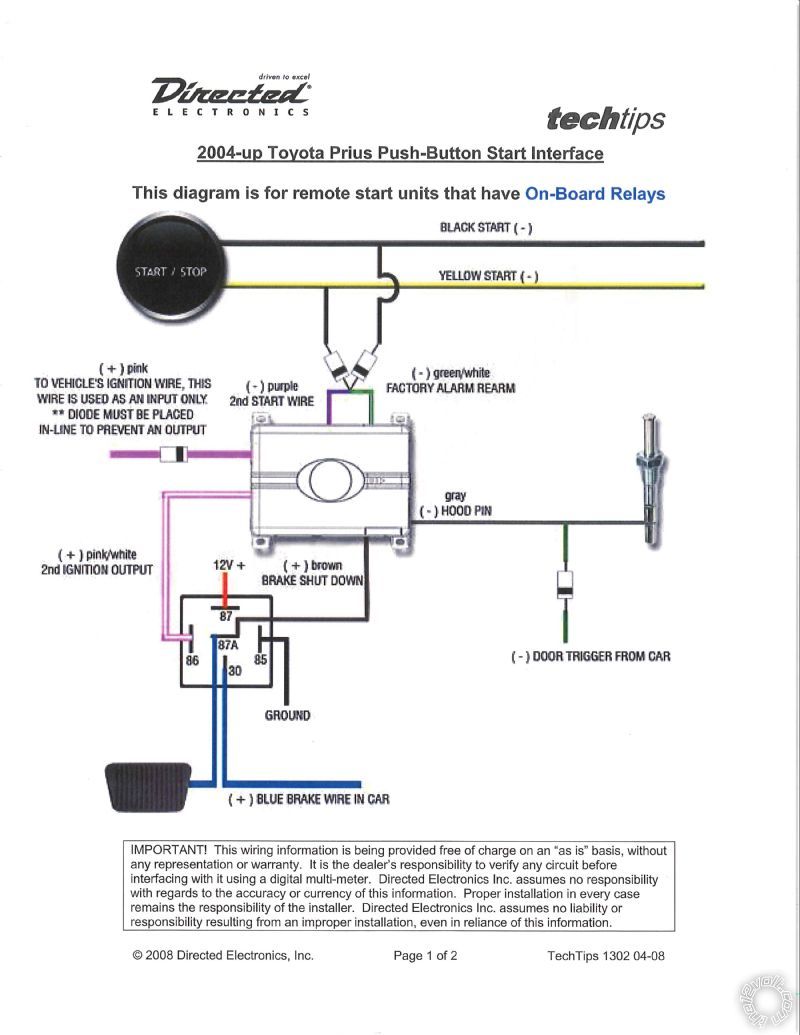

I pretty much followed the connection diagram on the Fortin website for the Evo-All connections and did my best at connecting the Viper to what I would logically think it connects to by following wiring diagrams. Cross referencing multiple and testing with meter when unsure. I have attached photos of my connections so far. Thanks in advance for helping me correct what is wrong or finishing what I have started.

I have made the connections as described in this image currently.
This is a Tech Tip I found on this site that I have not implemented yet as I believe the Evo-All is handling this.
