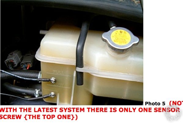

hi thanks for your reply i am creating a low level alarm as my car does not have one fitted and there is a system you can purchase that uses the water as a conductor to earth by simply inserting a self tapping screw into you header tank here is a picture from the install instruction showing the screws the latest kit only uses one screw to obtain a ground

That photo....2 self taps into the header tank? I don't think so, especially if you live in a climate similar to where either Oldspark or Mr. Idiot live.
Come to think of it just try and drive into Central London on a nice summer's day.
Self tappers into plastic?

And that might be an unpressurised overflow tank which I think is more common these days (not to be confused with remote headers).
But you'd think only one probe (self tapper) would be needed - unless they are using a dc-offset ac.
But I bet it's a plain old dc system from someone that is none the wiser....
LOL - they used to make chips for fluid detection....
