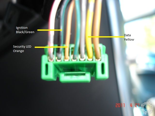

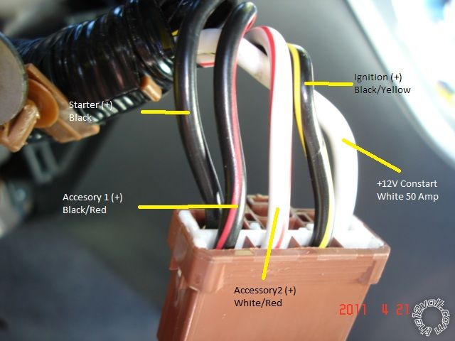

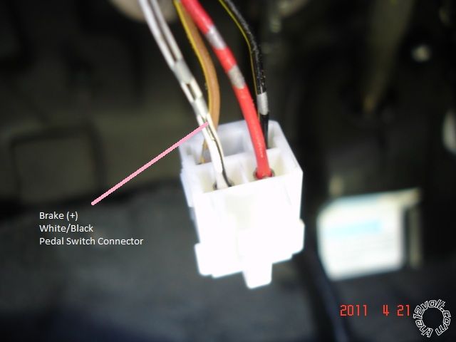

Here are some pictures from a recent 2008 TL.   Your 2006 should be the same.
prep for idatalink, viper 5902  -- posted image.
The 2006 Starter wire is BLACK/ White.  Use the Flex relay for ACC2 & program Viper accordingly.

I used a ADS AL CA flashed with ADS AL(DL)- HA Ver4.71 firmware.  Wired completely in W2W mode.  No issues at all.  Which iDatalink module are you using, ADS AL CA or ADS DL?
