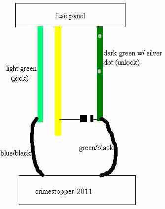

Ok, I'm a bit confused with the doorlock situation. While I was removing the old alarm, here's what they did (and it seems to work). Behind the fuse panel, there's a connector that's got a bunch of wires going into it. They have the lock wire from the alarm going to a light green wire in that harness. Then they have the unlock wire from the alarm going to a green wire (with a silver dot). But then....they have a diode going from a yellow wire (also in that harness) to that same green wire. See the picture below, that should make more sense.
Can I just mimic what they're doing? It unlocks and locks all of the doors every time. Although if this is wrong, that would be bad to mimic :)
