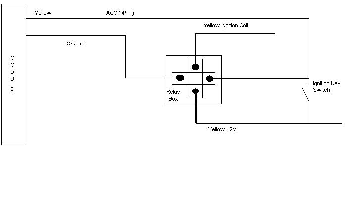

ive understood most everything on my alarm install except for the relay system, i have made a diagram of it. i understand were the acc wire and the orange wires go, the 12v does it go to the battery or DC and where would i find dc in my car, yellow ignition coil i get, the only other thing is the switch connecting to the 12v and the acc and how i do this. please help thanks
rancidpunk
Member - Posts: 6
Joined: April 12, 2005
Posted: April 14, 2005 at 12:37 PM / IP Logged
sorry pic didnt work first time let me try again
96 neon, Hiteeh HT - 455 -- posted image.

Is this for Ignition Kill or Remote Start??

its for a dodge neon 1996 and im trying to set up the relay for the ignition for an alarm. the alarm is a HiTecH ht - 455. i just want to understand what the switch is and how to wire the damn thing

If this is for Ignition Inhibit or "Kill"
Ignition Kill will not work on ALL vehicles.  U could send the wrong signal to computer and mess things up.
Starter Kill ( or Interrupt ) would be better.
SPDT Relay
1 or 2 amp Diode across PIN 86 & PIN 85 with stripe facing PIN 86
Cut Starter wire in half:
PIN 86 & 30  = Ignition switch half of cut wire
PIN 87a  = Starter side of cut wire
PIN 85 = Negative Output from Alarm while Armed
