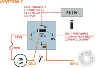

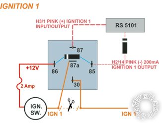

I have made 2 relay diagrams after your suggestion regarding Ignition 2 or Ignition 1 wires.
Viper 350, 530t, 2009 Dacia Logan - Page 11 - Last Post -- posted image.
and
Is this correct ?

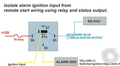

On the other hand I found some DIY Troubleshooting from Directed and at page.11 says to isolate ignition input from alarm to prevent trigger while remote started using status output.
[URL=http://www.drdetailshop.com/DIY_Troubleshooting.pdf]DIY Troubleshooting[/URL
Is this schematic ok ? It's more convenient for me.
Thanks
Posted: April 19, 2013 at 1:32 AM / IP Logged
The lowest diagram is exactly the upper one I showed you the other day, it was my first suggestion.
Except you've drawn it better.

Posted: April 19, 2013 at 7:55 AM / IP Logged
Well, it looks like the last diadram it's ok for me. Does not trigger the alarm any more.
I have adjusted the sensibility of the shock sensor a little bit lower for warns comming from alarm with ignition on (shaking of diesel engine).
Overall I'm satisfied, we'll see in time the behavior of it.
Anyway, Thank You Howie, again. Cheers
