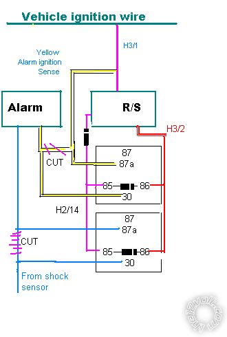

Hi, I have successfully installed my RS (viper 5101) and it works ok. I still have an inconvenient regarding the integration with my security system (Viper 5002)
When I start the car by remote (5101’s remote) the alarm from viper 5002 is triggering and it blows up the siren.
How can I start the car without triggering the alarm ?
The steps which I make:
MTS ok.
Leave the car, lock the doors with 5101 remote, the engine shuts off.
Arm the car with 5002’s remote (for alarm)
To start the car remote:
Disarm/unlock the car with 5002’s remote (If I start armed, it’s triggering)
Remote start the car with 5101 remote
The car starts but cannot arm again with the 5002’s remote. If the engine is running the 5002’s remote DOES NOT respond to any command.
If I connect the H1/10 WHITE/ BLUE 200 mA (-) channel 3 from viper 5002 to H1/10 WHITE/ BLUE (-) REMOTE START/ TURBO TIMER ACTIVATION INPUT from 5101 the car starts using the AUX 3 from 5002 remots but cannot arm using viper 5002’s remote. The viper 5002’s remote does not respond to any command.
It’s very annoying for me this thing. The main problem is that I cannot use my security remote to manage the RS, especially the triggering thing.

Can I use the H2/10 Dark Blue from RS (-) 200mA STATUS OUTPUT connected to the hood pin wire of the alarm brain ? As long as the alarm sees the hood as open, it will continue to ignore the shock sensor ?
Right now at the hood pin are connected the wire from alarm and the one from RS - GRAY N/O or N/C (-) HOOD PIN SWITCH INPUT. Just an thought.
I just need to bypass alarm while remote start.
Posted: April 17, 2013 at 5:24 PM / IP Logged
Just do this, in fact initially just do the shock sensor wire and see what happens.
The 3 x 1N4004 diodes are absolutely mandatory.

Hi Howie, I have the shock sensor built in the alarm's brain.
Posted: April 18, 2013 at 1:58 AM / IP Logged
Sorry, this thread is becoming a bit much, you mentioned instant trigger and I was confused.
The basic problem is that you need to throw away or sell on your separate units and buy a combo such as 5202, 5204.
Posted: April 18, 2013 at 2:00 AM / IP Logged
One more thought, is there a second ignition on this vehicle?

Posted: April 18, 2013 at 2:57 AM / IP Logged
I cannot sell or throw away the module, I just bought it, at least not now.
At the ignition switch I have 4 wires which I connected to RS:
- 12v+ constant (RED)
- Ignition (Yellow)
- Acc (GREEN/ YELLOW)
- Starter (Orange)
What about second ignition wire ?
Posted: April 18, 2013 at 3:02 AM / IP Logged
Try that isolating trick on the second ignition, that's how it works on Peugeots, might be worth a chance.
